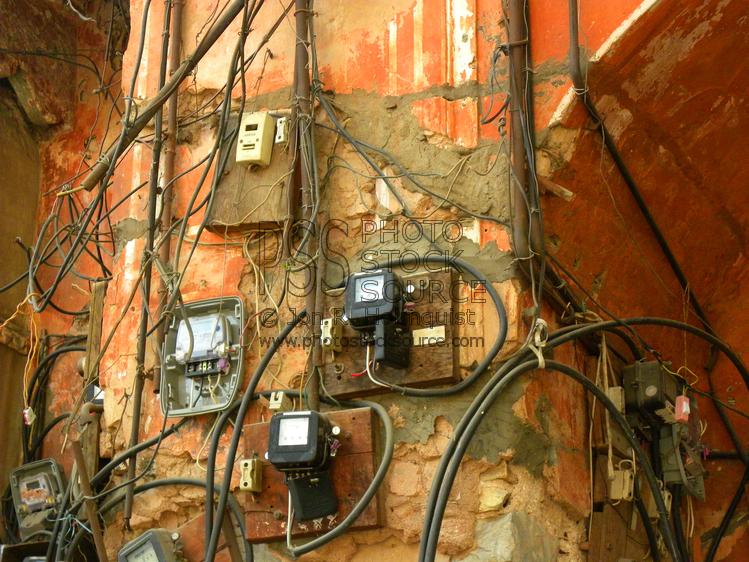

  12. cheers for that @finm, I've followed the above religiously and think I've got it done ok. Its getting a bit hot, so i am holding some wires and standing in a bowl of water to cool them down.
    It looks like this now - should i be getting a reading of -273.15 celsius?
