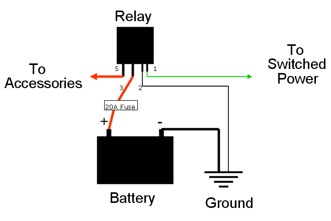

Hello I'm preparing the bike for a tour of Portugal. I'm going to be adding Givi Led spots so they can see me coming, a tomtom to show me the way there and a tank bag with USB ports inside to keep phone,batteries and other gizmos charged. The advice I need is the best way to power all this? I've found the sat nav feed under the left hand panel. Should I use this for just the lights and then take everything straight off the battery or split the sat nav feed and power everything ? And would that little cable cope with it all? Many thanks for any assistance. Cheers
I have the sat nav feed powering the sat nav and also a switch to trigger a relay which in turn powers the spotlights from the battery via a fuse... In your case i would use the sat nav feed to trigger the relay and power everything that way. It is linked to the ignition so you cant leave something charging and flatten the battery.
Thanks Stonesie, forgive my ignorance but how would I connect everything to the sat nav feed ? And dies the relay get triggered by a device calling for power ? Thanks
The relay would be switched on by the power from the sat nav feed and supply power from the battery through a fuse. The connectors they use for the sat nav feed are only rated at 3 Amps.
