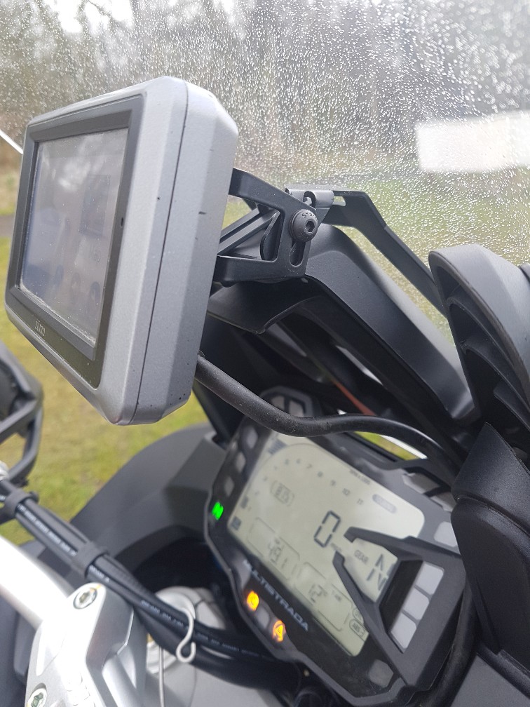

  1. Does anyone have a quick rundown of how the Mount fits? Or is it straightforward?
  2. It's very straightforward
    Remove the screen bolts
    The main bracket fits over the holes and a smaller bracket grips the screen adjuster handel then you simply refit the screen bolts... The sat nav is set above the clocks
    Only downside is you will get some wobble when going over rough roads hope that helps 20170316_102319-756x1008.jpg
  3. I just fitted mine at the weekend.
    Very simple, if not a little fiddly at first whilst every thing is loose. Maybe hand tighten the nav on to the bracket whilst you get into place before a final nip up.
    Once fitted its fantastic, puts the sat nav right in view but not in the way of the clocks.
