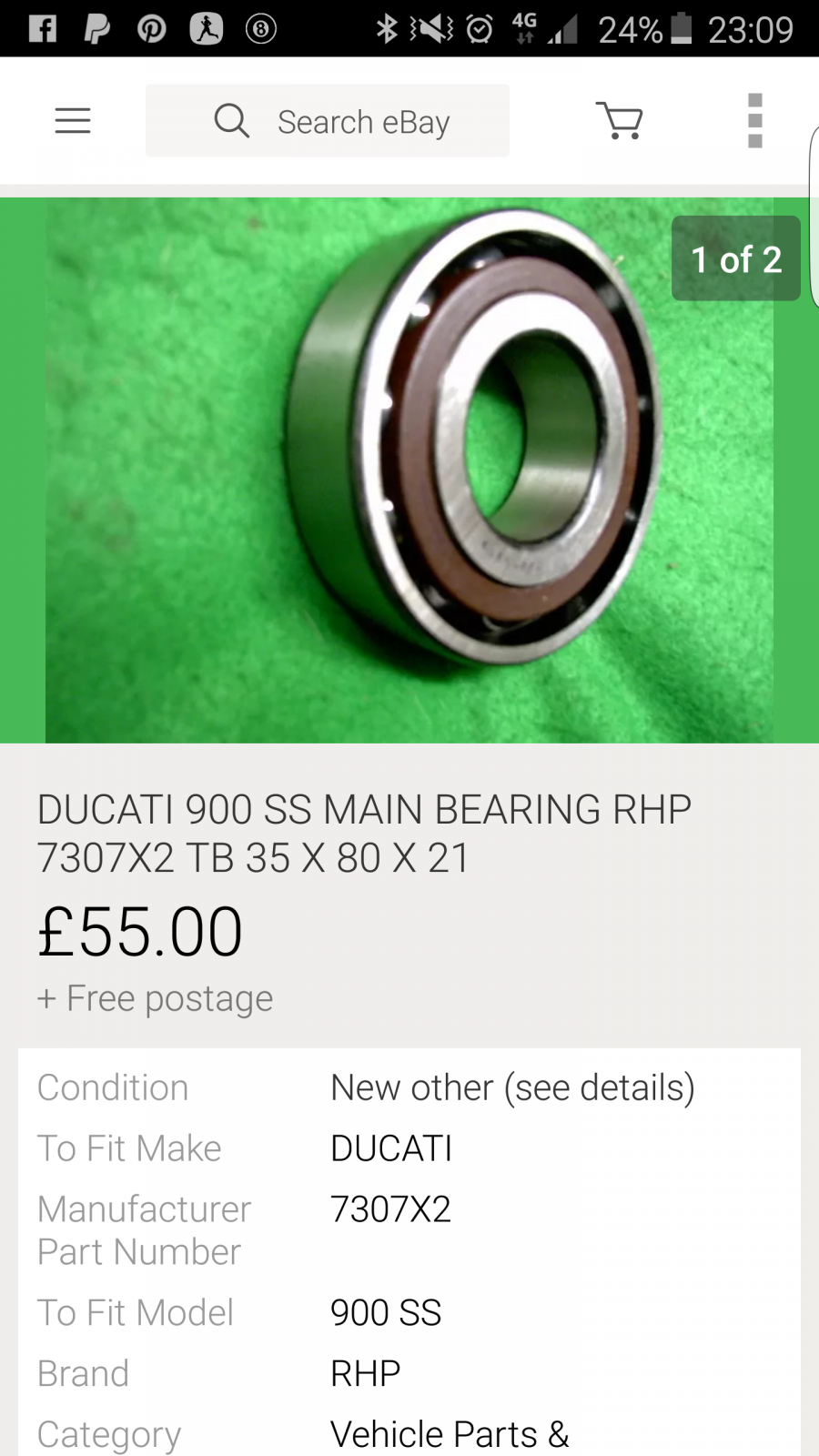

Is this any help? Ducati Mains Bearings or this? At least you can see what else they fit. Main Bearing - Bearing 7307 X2tb - Rhp » Athena Aftermarket Division Cuscinetto Banco Destro 7307 X2TB RHP Ducati Supersport 900 Superlight 91 97 | eBay and for good measure: Ducati Motorcycle Bearings £65 any good?
Wow, that last one seems too good to be true, gonna call them tomorrow just to make sure. As you have posted they appear to be 80£ a side normally!
