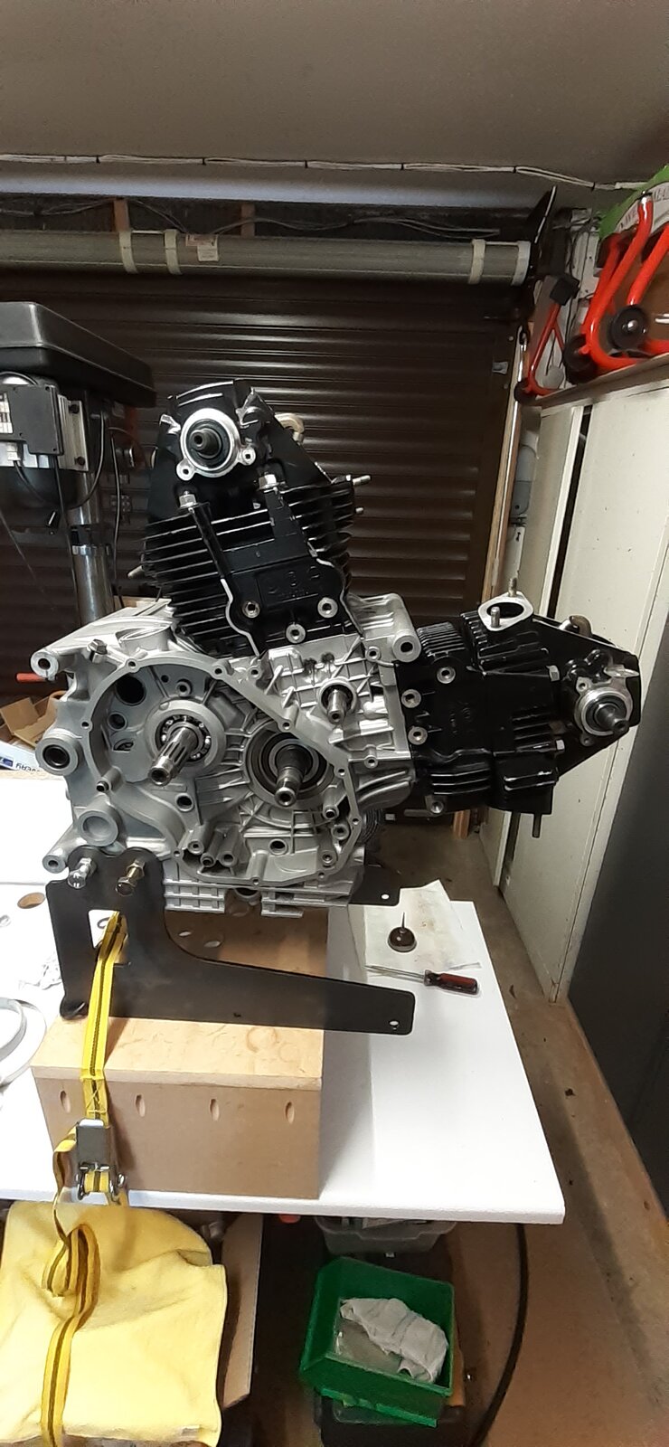

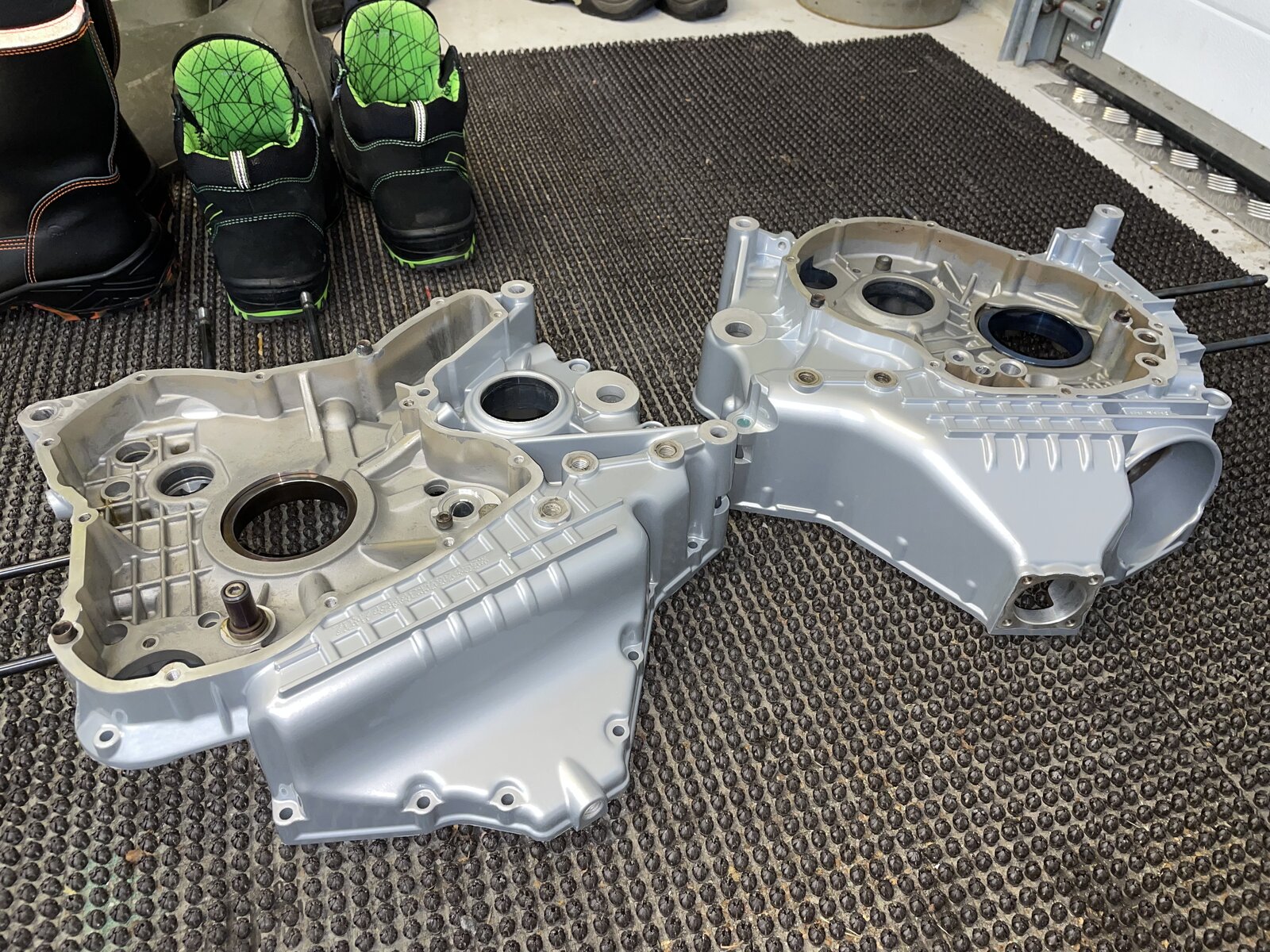

Now the job is done! First engine out, dismantle blocks and all bearings and sealings away. Then vapour blasting and a lot of cleaning with oil removal liquid. Then finally paint with powder coating. After vapor blasting all oil channels need to be cleaned well because that little blast material is going everywhere!
