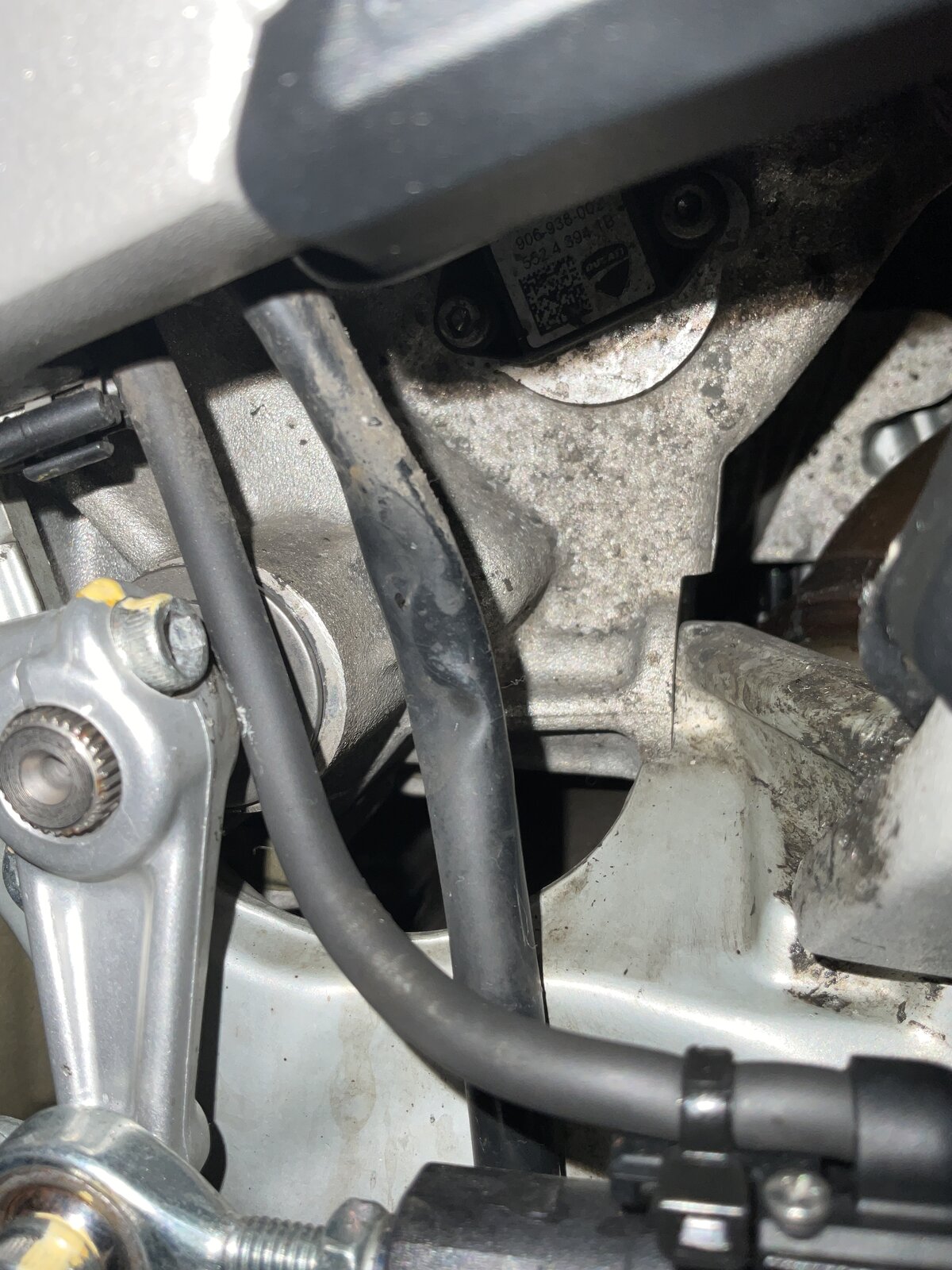

  1. Have a multistrada with baked in road grime it’s a v4 and it’s the lower front and sides, looking for a cleaner that won’t damage the finish but get it cleaner. I have tried muck off but it’s not really made much difference, used a brush to try to remove.
    any guidance would be appreciated

  2. Got any pics ? - is it corrosion or muck. Muck will come off. Corrosion will not
  3. Looks like tar, dirt etc.

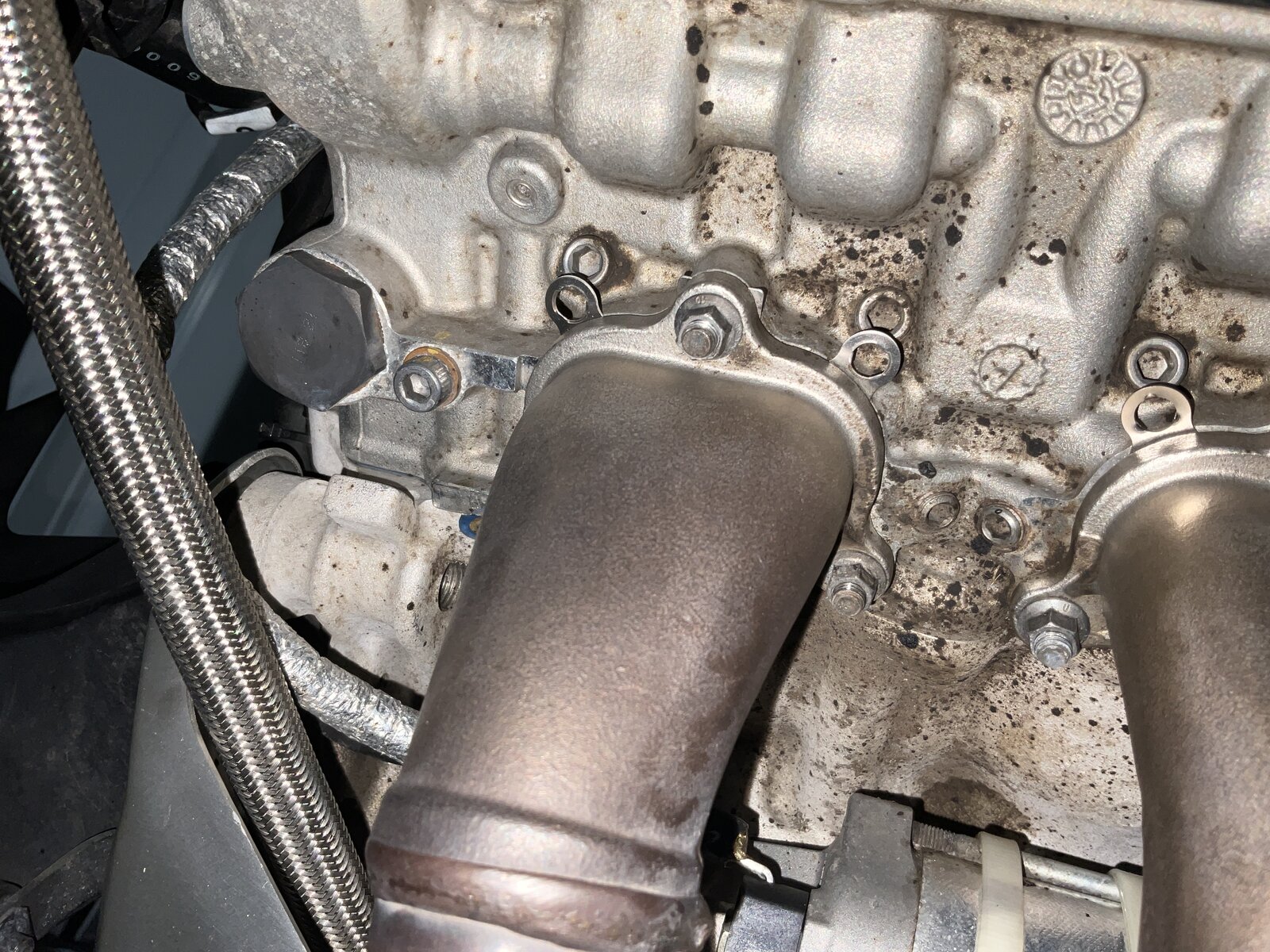

  4. Whilst I have it striped would like to clean it up
  5. on the second image the dark spots are probably tar. Which can be pulled off with Brake cleaner.. Might get some of the rest off too... I'd spray it and use a stiff nylon bristle rush see how you get on. the smooth cast piece should clean up alright. The sandcast pieces are harder if it's ingrained

  8. None of these will strip any of the colour off ? Is it a painted engine the v4 or is that the aluminium block.
    Have deep cleaned a triumph in the past and stripped the colour from the engine, but that was painted black.
    as always thanks for the advice, find it better to ask those that have done than just trust google and the crap you get in search results
  9. Neither WD40 nor Holts B&P cleaner will mark the paint. I’m not sure the gold colour is paint, it seems like an anodised coating, anyway, I’ve used them on mine with no detrimental effects.
