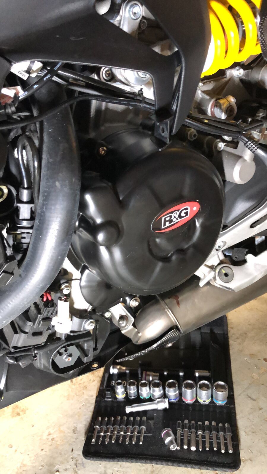

  2. It it’s the same as the 959 then the plastic shroud on the right upper of clutch cover has to come off. Around 12:00 - 16:00 hours as you need access to both bolt holes. I could not get the lower back most fairing hole on rhs (down by exhaust -1299 lowers) to line up but just used a zip tie as it was a track bike.

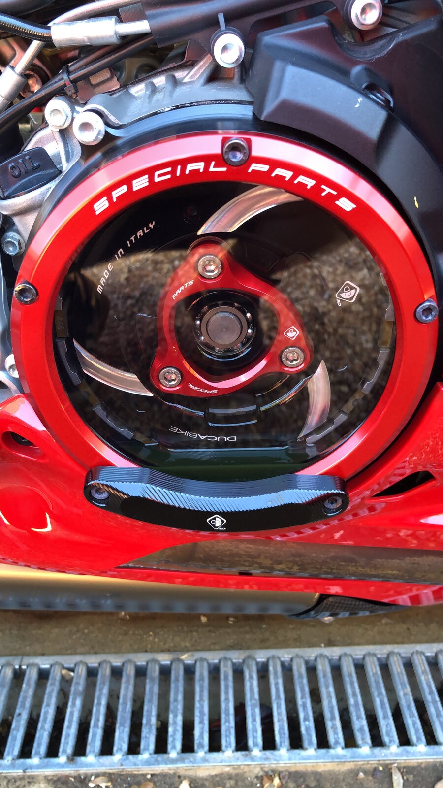

  14. Woodcraft all the way for practicality, When I damage my GB's it will be them for sure. In the end aesthetics are personal but you need something to protect the clutch cover as I have ground through a naked one easily on a slow lowside. When I do my dry conversion I'll be going thick alloy sliders of some sort, also I really don't get clear clutch covers- why do they exist??
  15. For the US market I think. I would like to say I got my bike used with the one pictured fitted. First job I did was to remove it and sell on eBay.

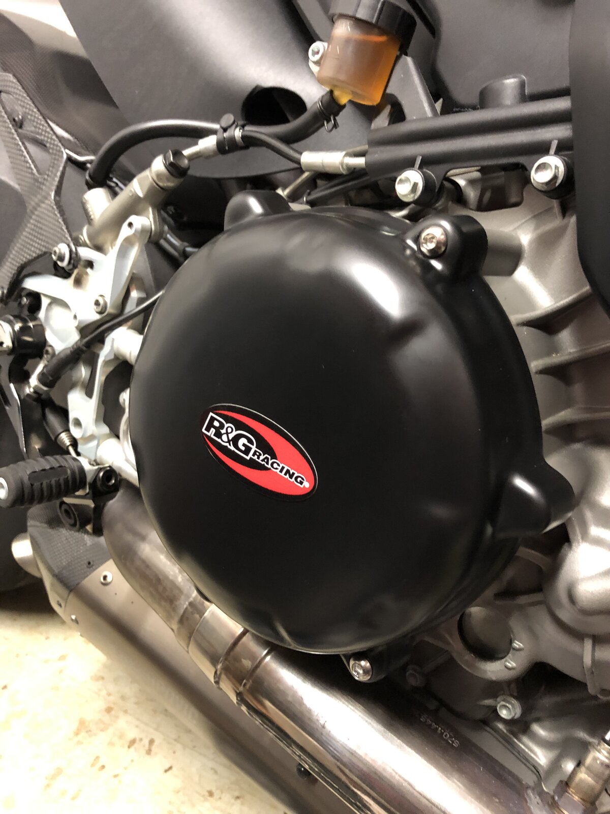

  16. For clutch side, it'll be fine for road fairings, other side is more tricky. I think the spider ones fit without modification, but main brands don't (R&G, GB racing etc). I had to cut A LOT to get the R&G one to fit.

  18. I fitted the R&G Race covers, and the Ducati performance race fearing kit. I can confirm it has to be cut a bit on both sides. No big deal, but nothing for a looker. BTW, the Ducati fearing is just the same as the standard, but no paint...
