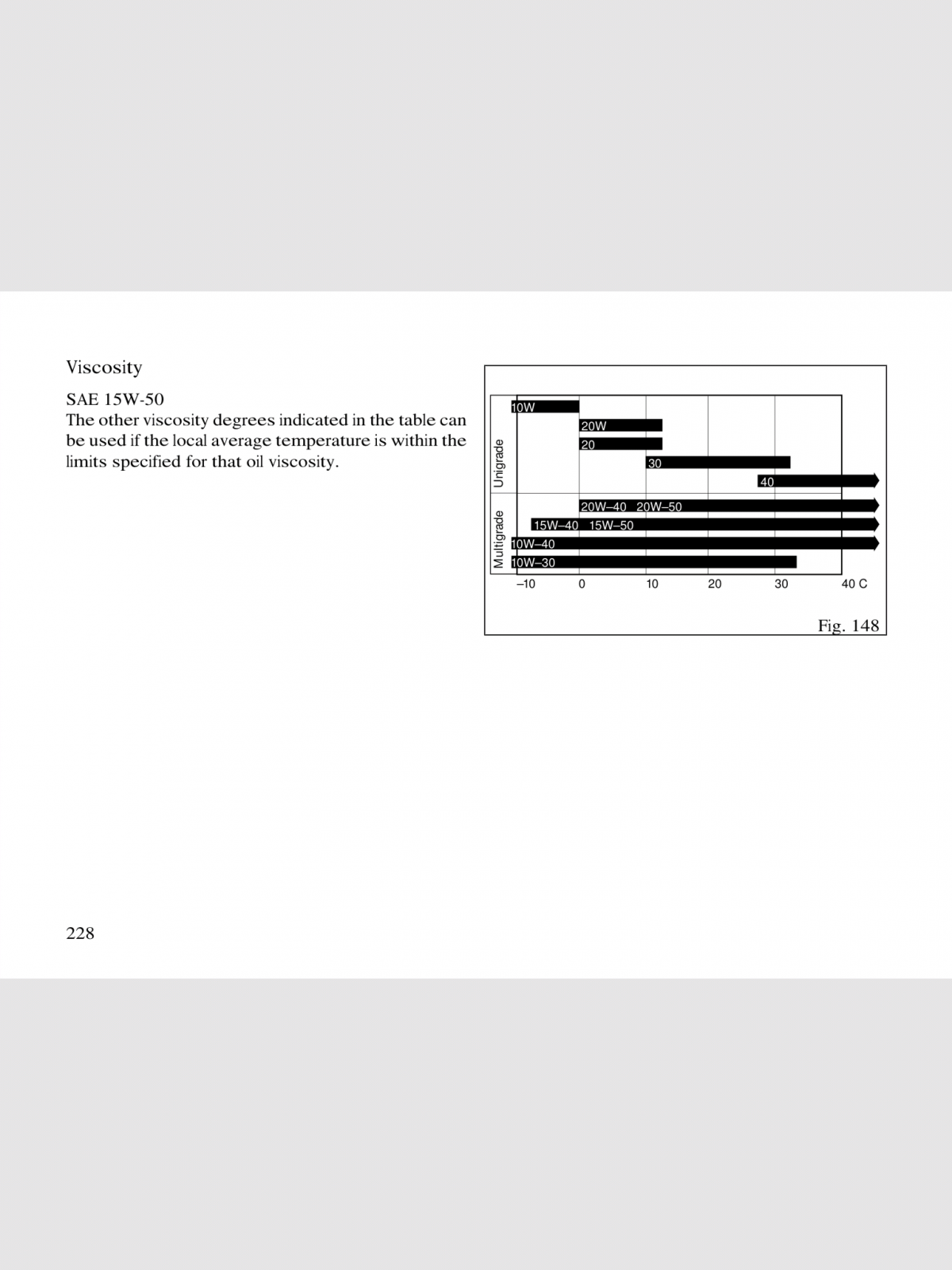

Users manual states that 10/40 is fine, provided you ride within the ambient temperature range that they state for that grade of oil.

This is from the 899 Owners Manual could not find this page in my 1299 manual..... Would think 10w40 should be just fine.
