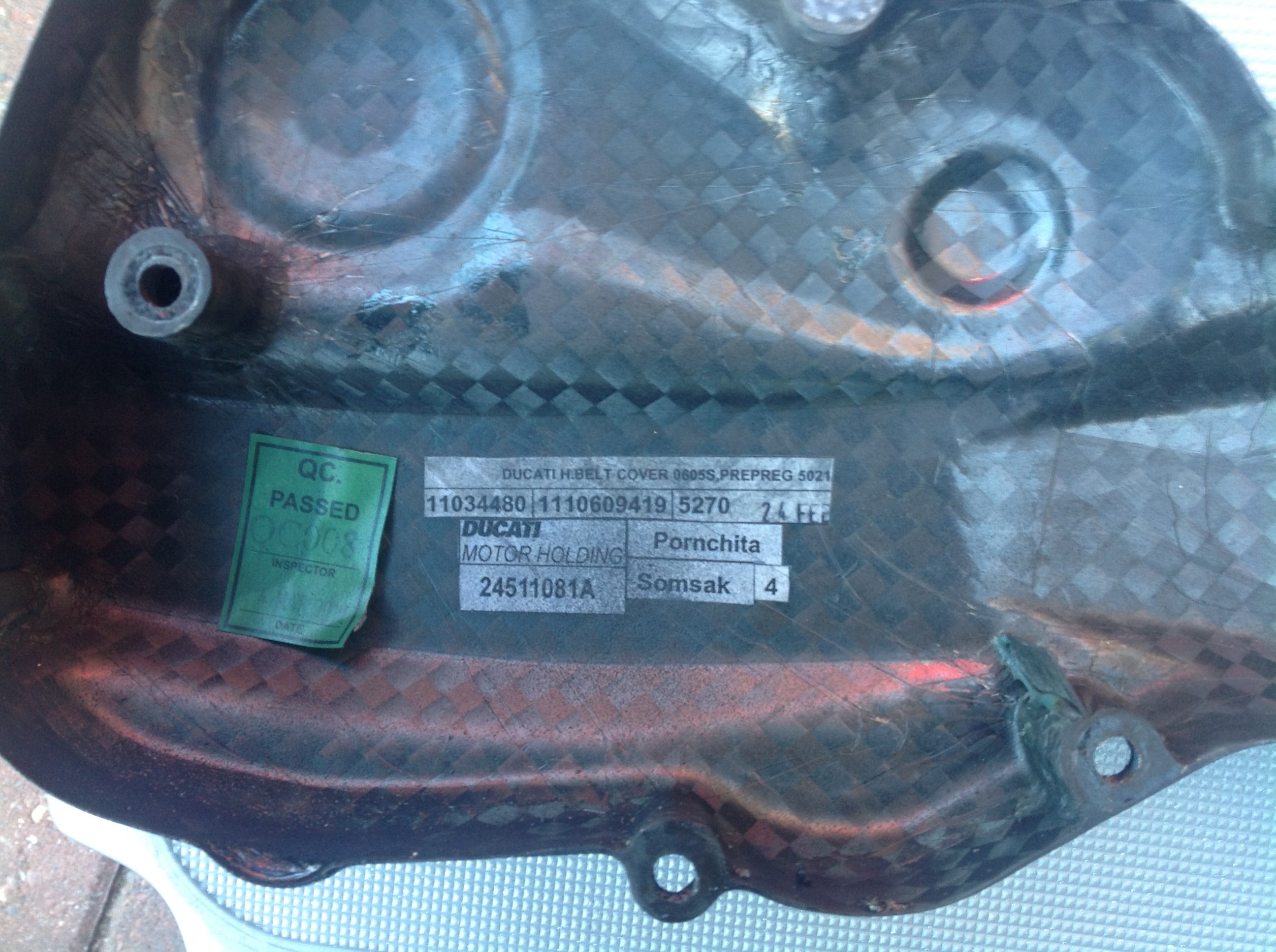

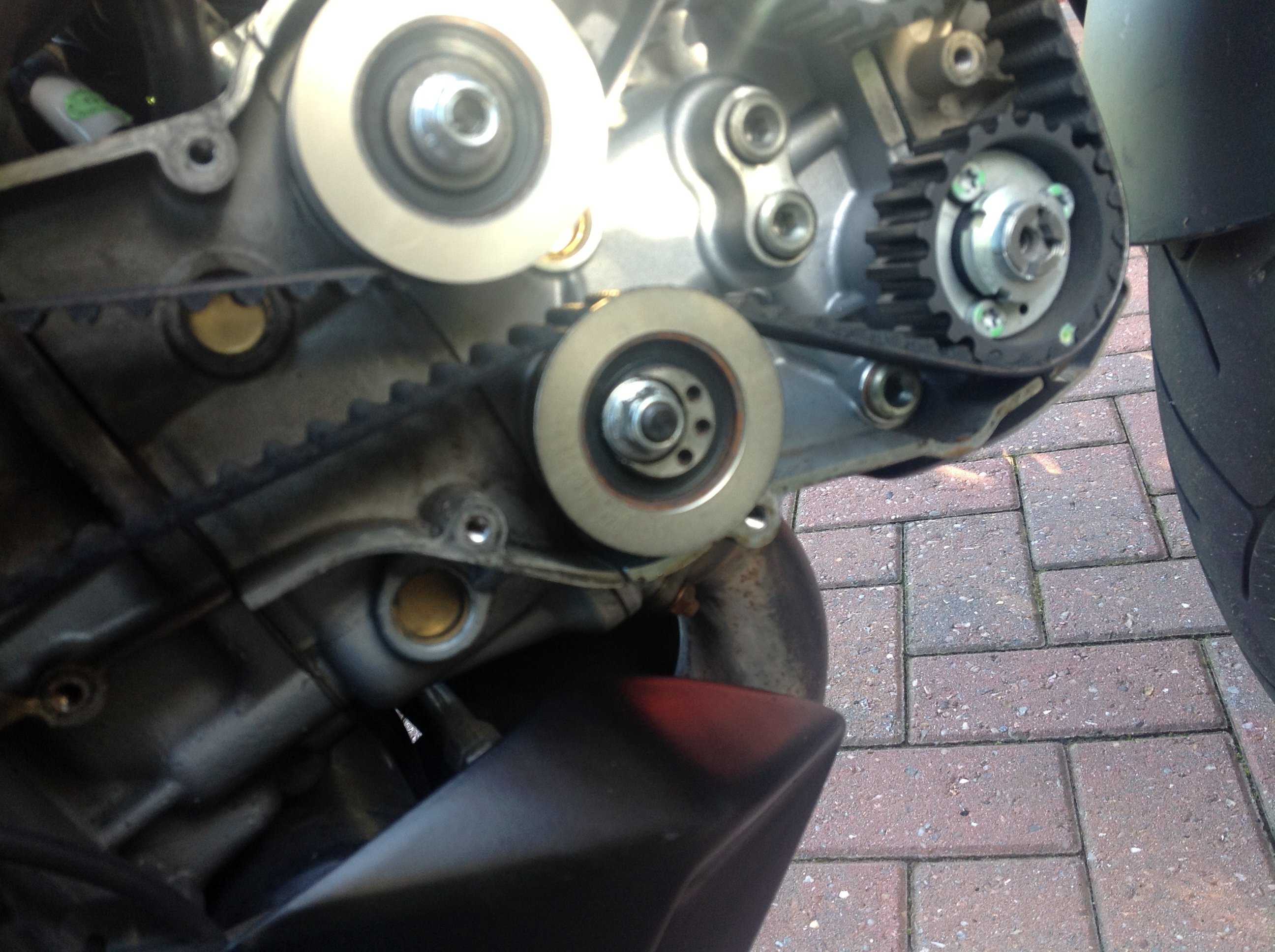

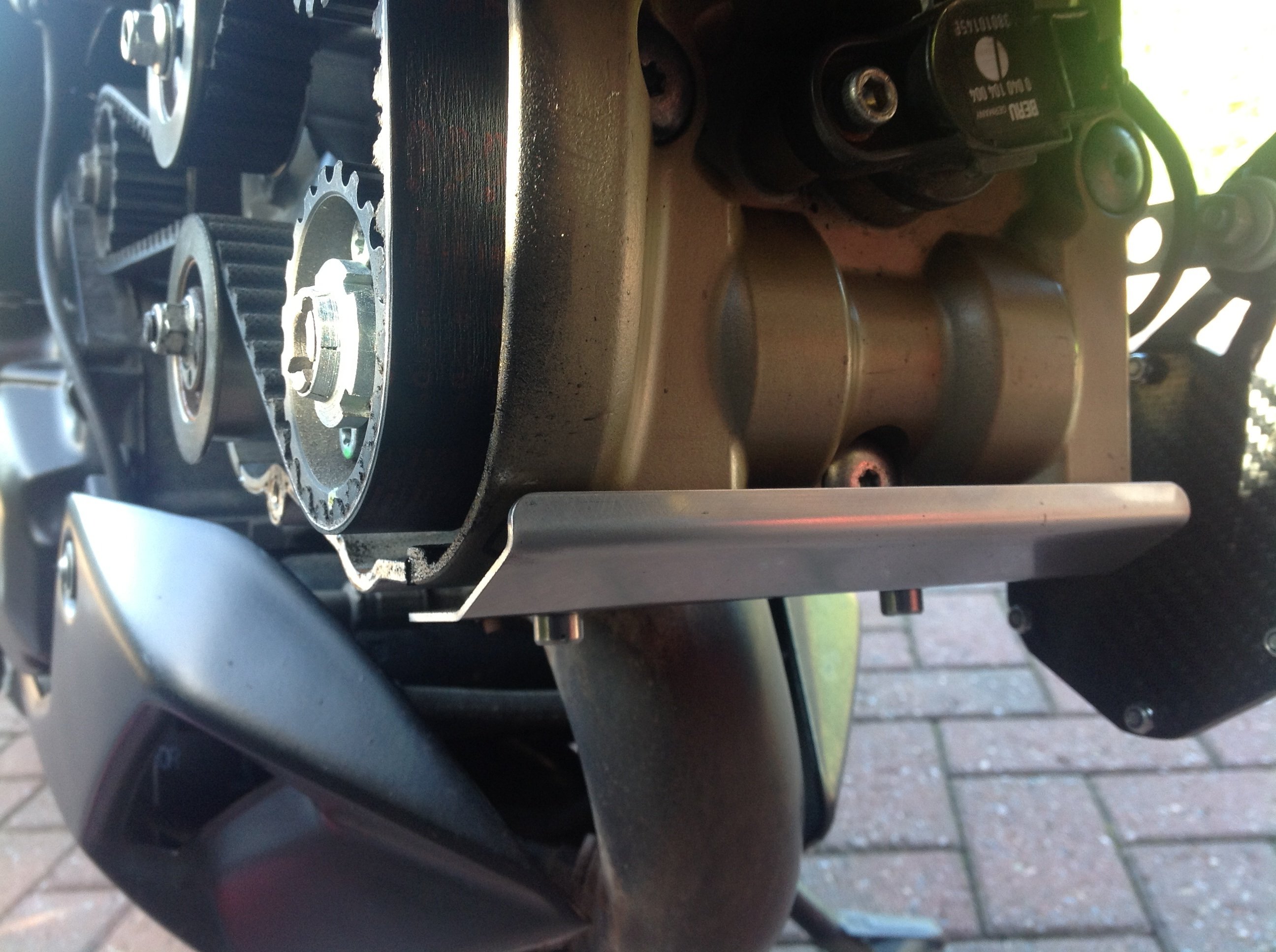

    Ok, nothing too drastic. The belts are dry and there is just a little evidence of oil misting in there, which has probably been going on since the rebuild? I am going to use it this weekend then keep checking it until I can get it back in for a "nip up".
    It may be just from the rocker cover, but the bolts are tight?
    #11 nsm3, Mar 21, 2014
