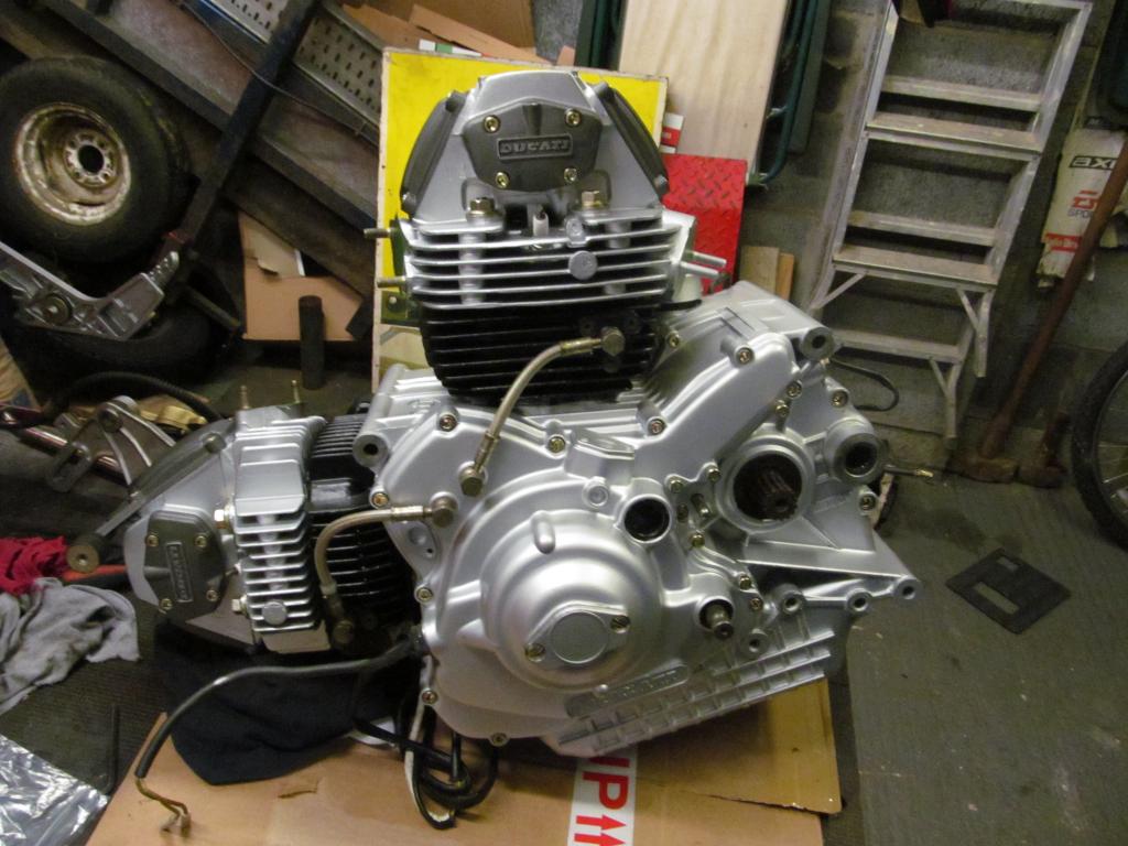

  7. I have posted this pic before but this is the result
  8. Nice, did you just run down with wet/dry ? Did you split the cases to spray?

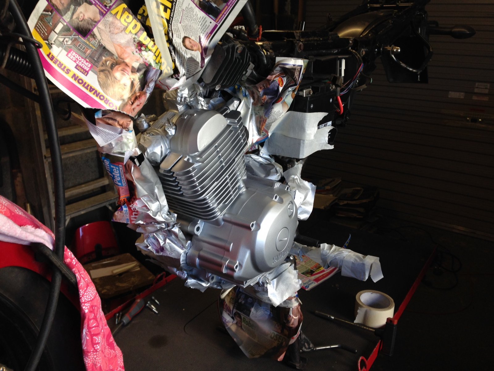

  9. The cases were apart to have the cylinder studs replaced ( a fault on early Monsters) So I took advantage of this. I cleaned then up with a combination of a wire brush on a Dremel and wet & dry / emery paper. Then decreased everything with thinners.
    I painted the wife's Yamaha engine in situ with lots of masking
