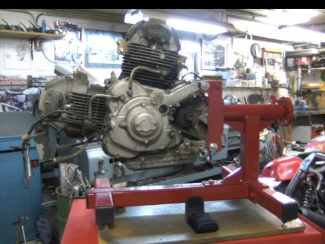

Easy to make something up like this... https://www.ebay.co.uk/itm/Ducati-E...314330?hash=item2f3832c55a:g:9oEAAOSwHbld66fY

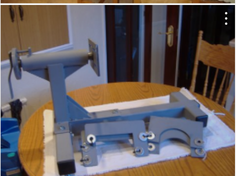

Here is one in box section 50x50x3mm 360° rotation on zz bearings with lock pin flat pack type when not used slip under the bench with a set of trellis and bevel laser cut engine brackets in 8mm steel made in UK Mike

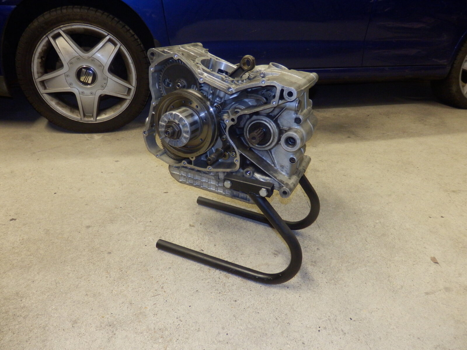

Whooly dooly, big money for what they are. I picked up one of these on a 40% off sale for $70aud (40quid): Dicked around with the mounts (cut and rewelded) and it’s a lil’ beauty:
Why complicate things. These do the job, are really easy to make, and don't even need to be as complicated as mine.: Nasher
Uk I make them to order 360 rotation with lock.pin 3 bolts all bolted up to use fir trellis or bevel brackets
