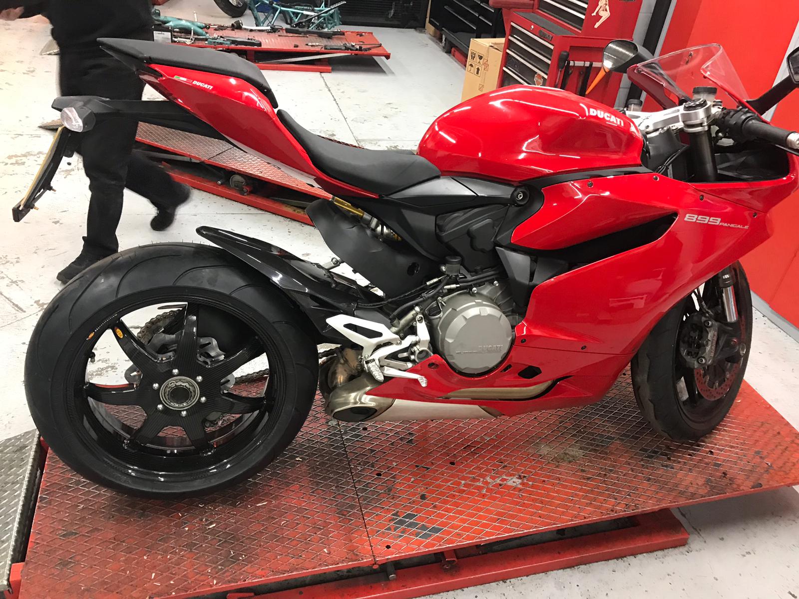

    #5 able duc, Dec 13, 2019

  7. oh I meant to ask do you know how much weight difference between the 899 swingarm and the 1199?
  8. I’m pretty sure the naked sssa swinger was lighter than the o/e 899 one. BUT when you add axle etc the sssa one is heavier. Which is why I have a BST rear wheel in mine.
    (I’ll see if I wrote down the weights).
    Fully fuelled mine weighs 192kg.

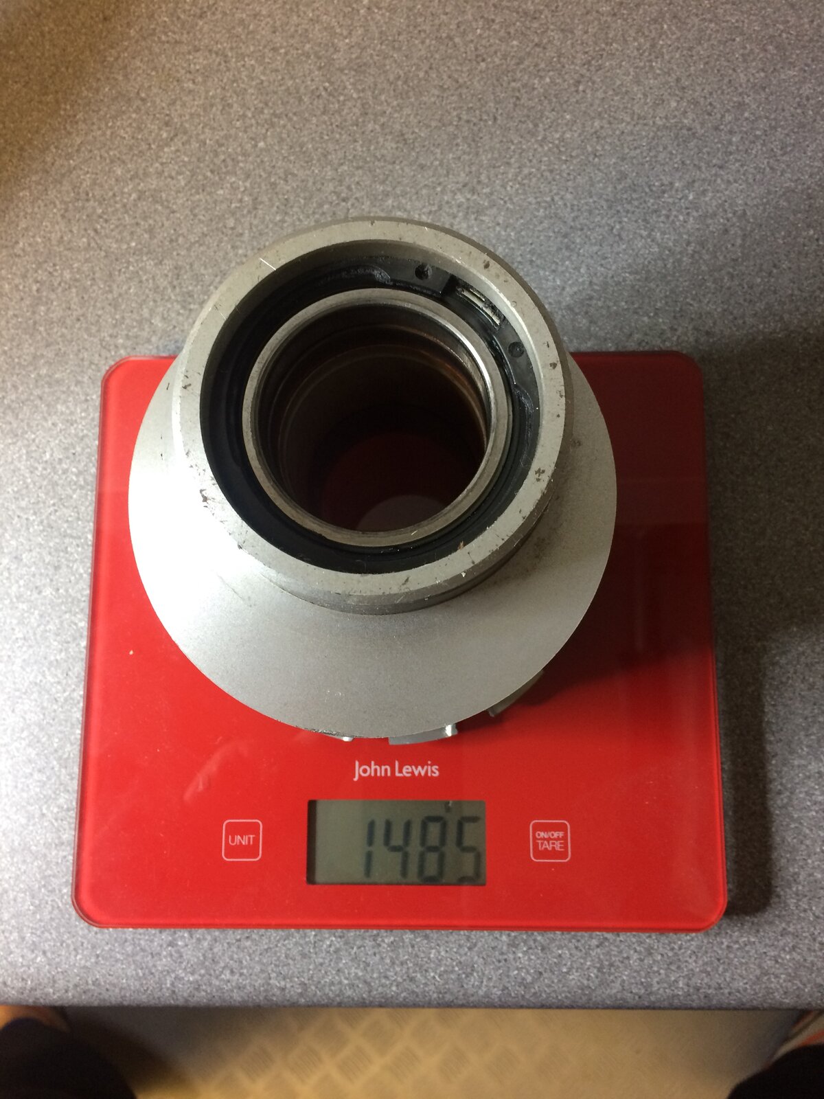

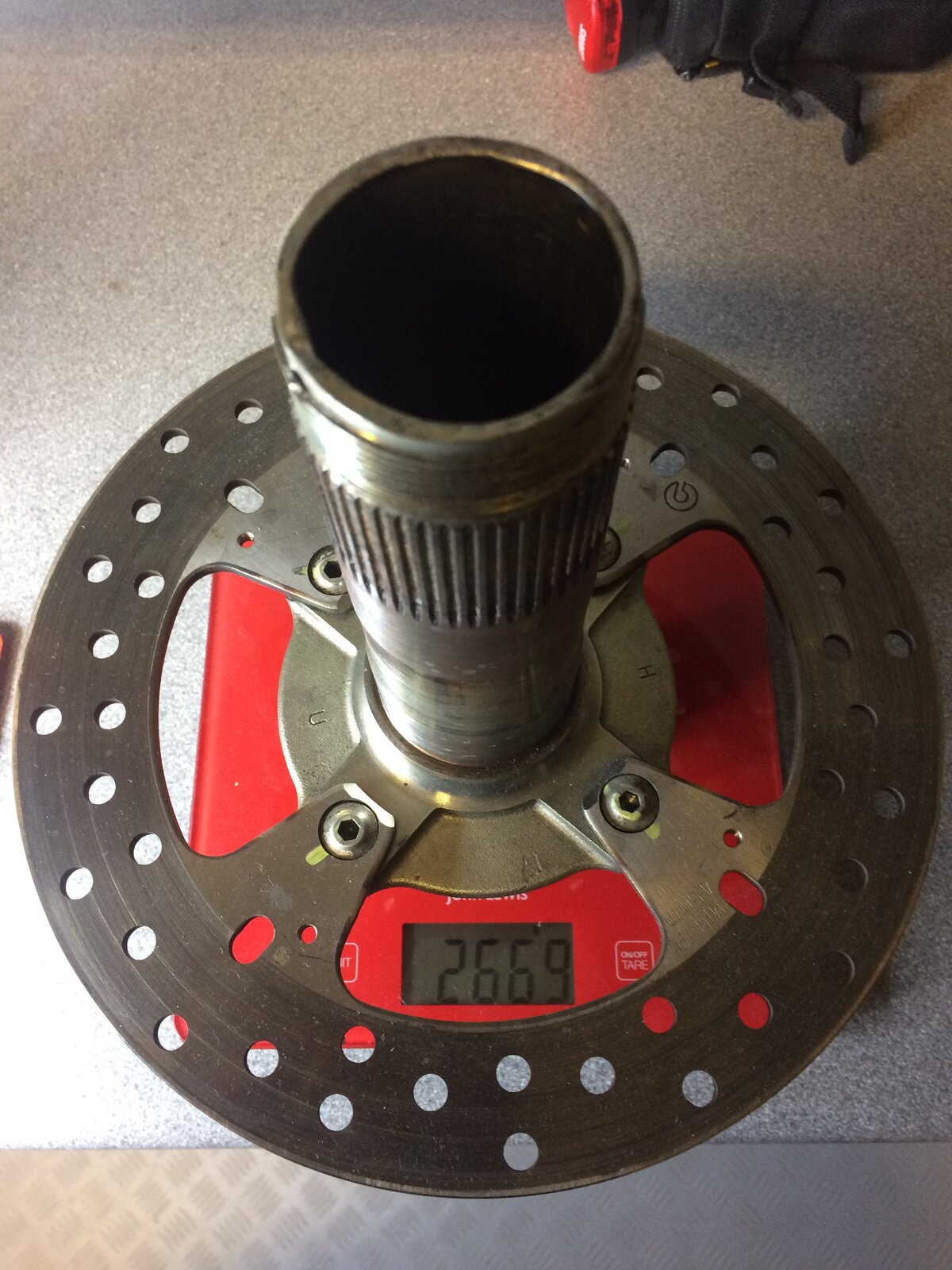

  13. @able duc not all the weight info but here’s what I’ve weighed:
    899 swing arm approx 8.3kg
    1199 hub is 1485g
    1199 rear axel with disc 2669g
