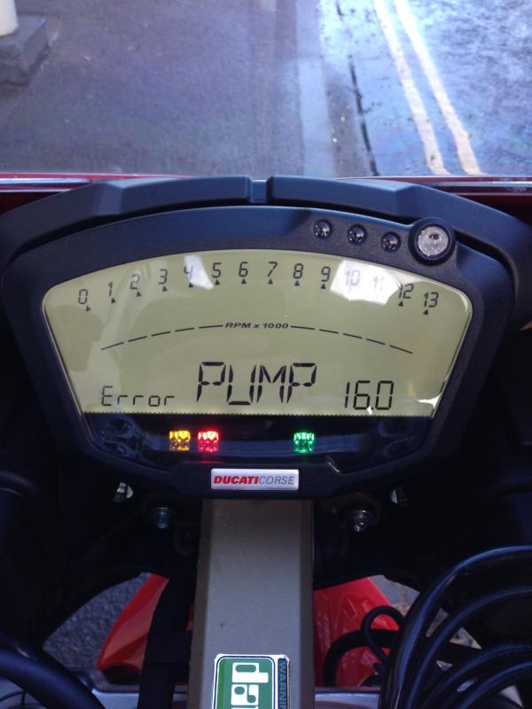

    So, went to ride the bike today to work. It stalled at the end of the road but I thought it was me, then it did it again at the bottom of the the town where I live. It was much more difficult to start and then wouldn't at all.
    I left it for ages, tried pushing and pulling the connectors for the tank, no joy. Pushed it home and then it started! although something clearly isn't correct!
    Anyone had this? See the attached pic, it's an 848 Evo (700 Miles from new).
    My suspicion is that there is some damp in there somewhere, as I washed it before I put it away, but I guess it will have to go back to the dealer and get them to have a look at it :-(
  2. RTFM...
    Error 16.0 = Pump Relay
