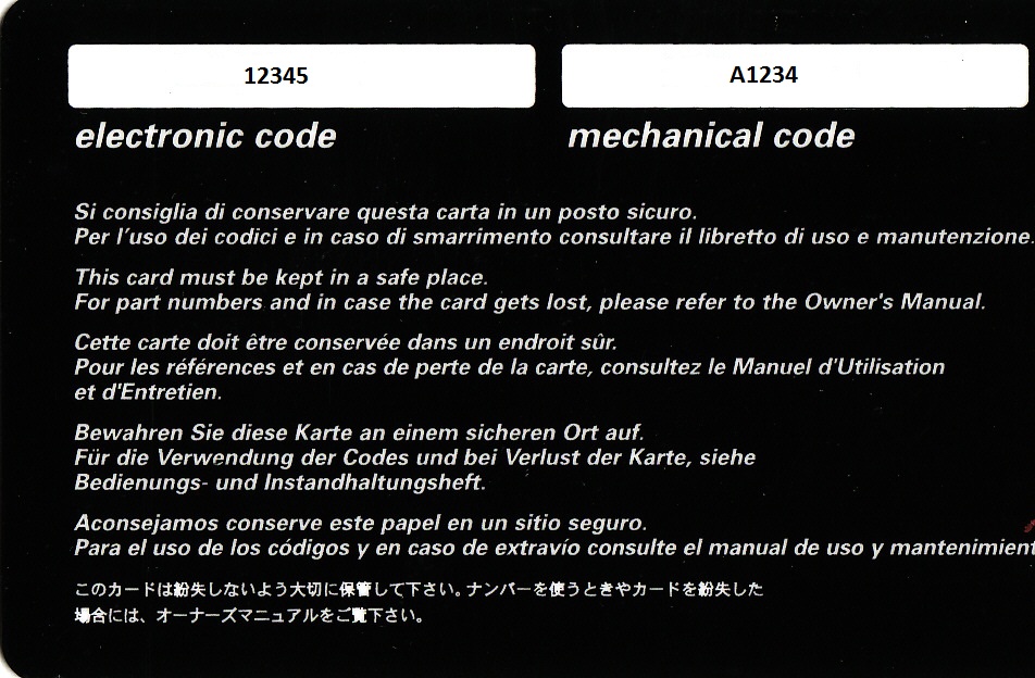

Underneath the guard around the ignition switch is the imobiliser aerial and they fail quite frequently it seems they let water in and it prevents the signal to the key or vice versa and shows as an imobiliser fault. Yours will have dried overnight in the garage and the fault will have gone. memorise your overide code or save it on your phone. If you get caught in the rain use the code at least you won't be stranded
not familiar with the overide code......I'm sure if I don't ask now next week I will need it.....could you clarify please
I'm not familiar with earlier Multi's I don't think yours has one like the latest models 1098 1200 multis etc
When new your bike was supplied with a code card to bypass the immobiliser. The one for my 999 looks like this
