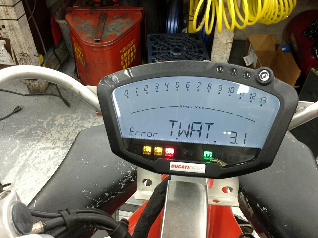

    I'm still waiting for someone to post that they have had one of the two the 'TWAT' error codes (T.WAT 31. and T.WAT 3.2)

  7. I think that one is for 140mph in a 40 zone isn't it? :biggrin:
