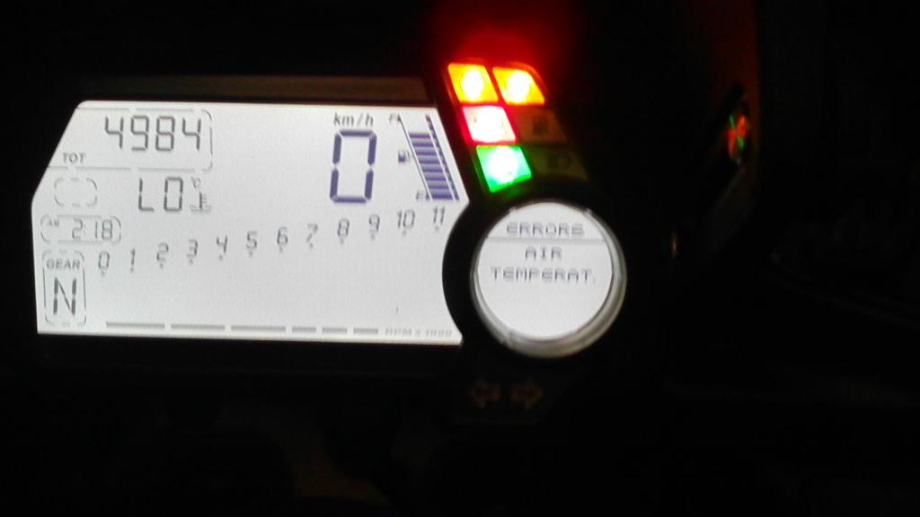

  1. Hi guys,after a bit of help,after fitting a new right-hand handguard and fitting the indicator wire under the tank I now have this error on the dash P_20140116_224517.jpg any ideas??
  2. Air temperature sender, located in RHS air snorkel. You might have unplugged or disturbed the wiring.
  3. Yep , sensor unplugged. You can reach up and plug it in without having to pull any panels, assuming you haven't inadvertently tucked the connected somewhere :wink:
  4. Thanks for the heads up guys will check tomorrow,thanks again
  5. All sorted ,thanks guys
