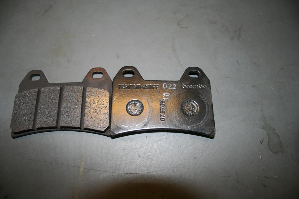

  9. Don't think so. Take a look on the back of the old pads if you still have them. There should be a Brembo part number and there's usually a HH designation for sintered.
  10. See image, origional pads in mine are marked 450FF not HH.
    interesting to see piston marks on pads are bias to one side!
