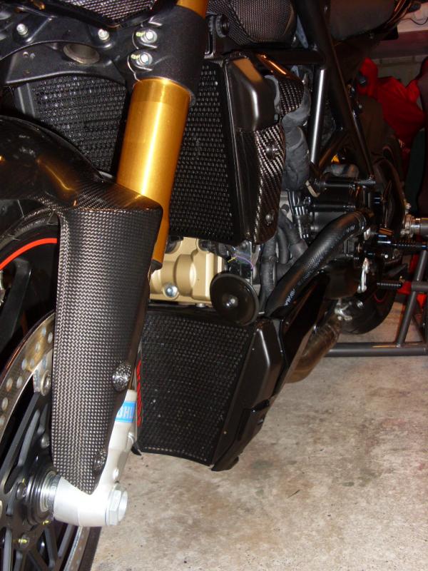

  6. Here you go, picture on mine fitted
  7. You might have cleaned her 1st ! :tongue:
    Mine on the SF (top & bottom)
  8. Clean?, that is clean :tongue: I will agree through, the V section does get an absolute pasting
  9. i thought my bike was clean but yours goes to another level :upyeah:
  10. I think that's because it was brand new when the picture was taken :wink:
  11. Well it was newish, but don't try to hide behind that fact Matt, yours is a disgrace :tongue:

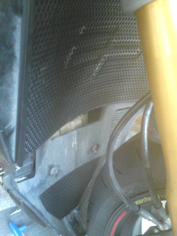

  13. This is what they look like after 13k on a SF - only fitted lower one, top radiator is still clean [​IMG]. Think I might take it off and paint it later :frown:
  14. Is that paint wear caused by gravel etc being thrown up by the front wheel, or by contact with the front wheel under braking, as dukeman358 mentioned?
  15. That's water and road grit doing that
  16. Yup - shows it's doing it's job :)
  17. I'd be interested to see a picture of the radiator when you remove the guard to paint it Char.
