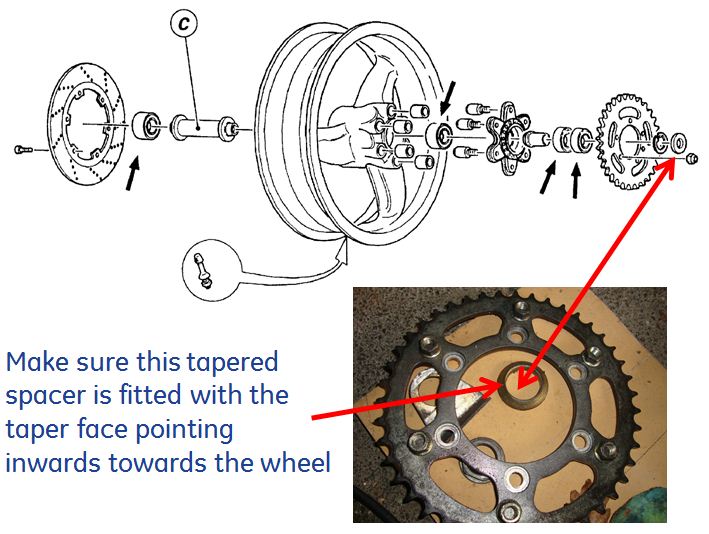

  1. Hi - I had some new vibrations appearing from 4000 rpm upwards and could feel them through the bars & footpegs.
    Initially I thought they were engine related and possibly main bearings on the way out. Anyway after some investigation I tracked the vibration down to a failing rear wheel bearing on the brake disc side. I have replaced all four bearings (two in the wheel hub & two in the sprocket carrier) and my vibration is gone.
    I will fit a new chain & sprockets next as these were also showing signs of wear.
    Here are some pics that may be of use, including the SKF bearing reference numbers
    Wheel bearing is 25mm ID x 47mm OD x 12mm Wide
    Carrier bearing is 30mm ID x 55mm OD x 13mm Wide ( see pics for reference numbers )
    HAPPY RIDING
