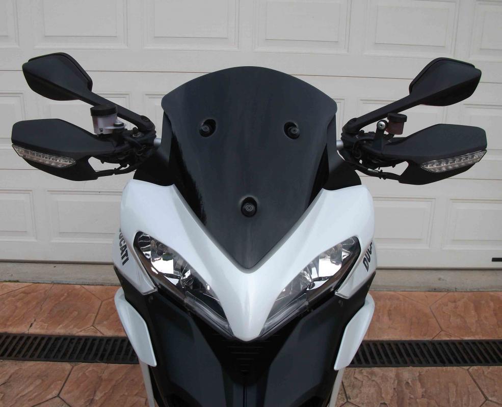

  1. I’d like to share this with you (not the wind lol) and it may be familiar to some, as I’ve previously posted it on ducati.ms on the “Hiss Flaps” thread under my “uncledon” username.

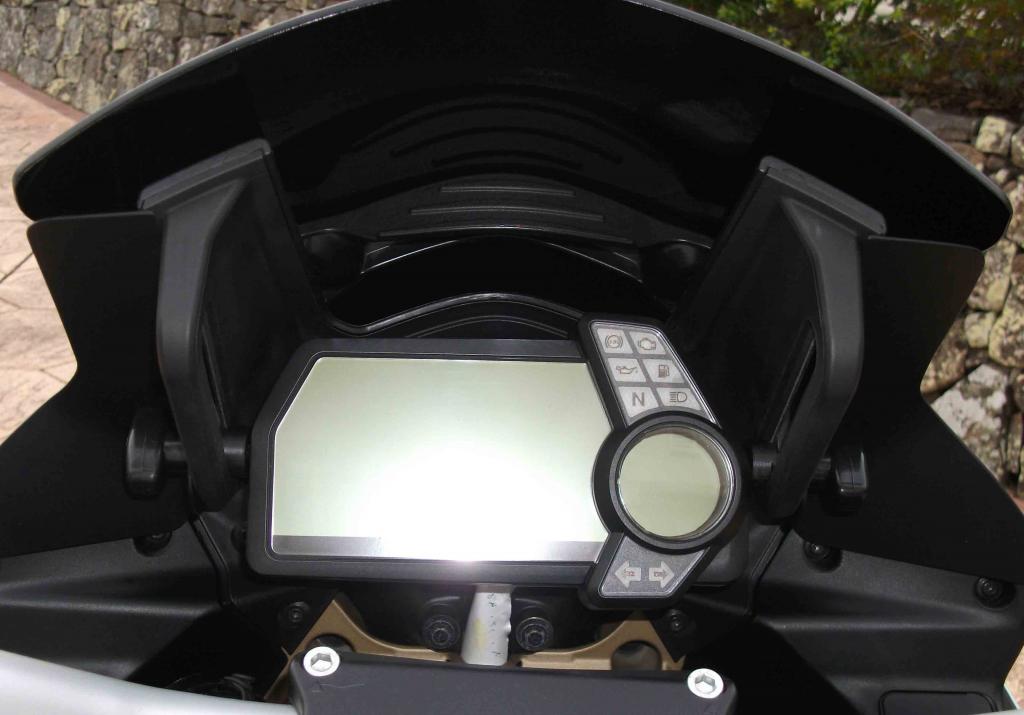

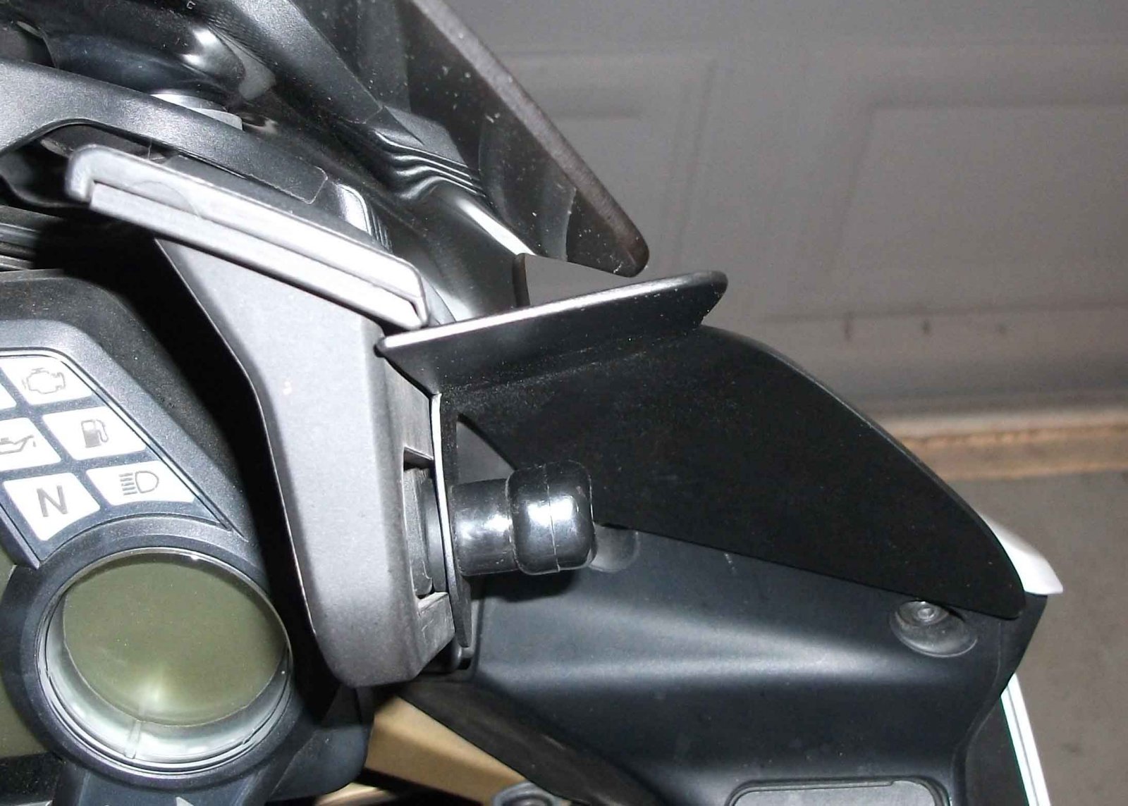

    This is my version of CP’s “wings” made from 1.6 mm aluminium, and now with a 35 mm curve to match the fairing.
    They are fixed to the screen slide...not the fairing screws and they eliminate the buffeting by deflecting the rush of air from the nose cone, out and past my shoulders.
    I’m 5’11” and this is what I've tried so far…
    The stock screen fully up with my wing version…better, but still unacceptable.
    Added my home made Aztec style spacers… much better and acceptable, but I didn't like the unexpected sideways shoving from crosswinds, so I removed the spacers.
    No screen… totally different bike, much cleaner air and acceptable to me.

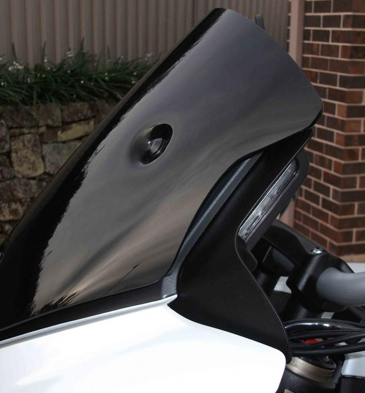

    So, with this in mind I cut the stock screen down by 5” and painted it black on the inside to match the black wings.
    The original fixing set up was not suitable for my wings so I sourced some black thumb screws and machined up some nuts from black acetal to replace the originals.
    With the screen and wings fixed together at the lowest position I’m very happy with the result…here’s some pics.
