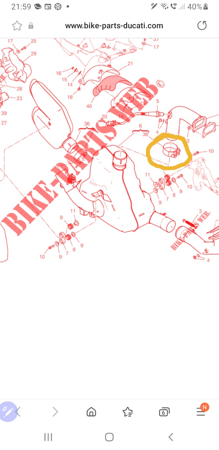

  1. Could someone tell me the torque for the exhaust clamp please.
  2. Not aware that the part has a torque figure. Looked through my 1200 workshop manual and can’t find anything. Andy
  3. Workshop manual for 1200 DVT MTS states 18Nm for the "Pre-silencer to vertical pipe retainer", I think that's the component that you're indicating in the diagram.

  4. Checked my manual again and still can’t see anything :( Does 18Nm seem a little high to you ? It’s what, a 4 or 5 mm bolt ? Andy
  5. Have just looked it up and that's the correct value, see page 840 and 841 of the manual, Specifically illustrates that clamp and states "Tighten clip (11) to a torque of 18 Nm ± 10%.".

  7. Thanks for the reply. 18 it shall be :)
