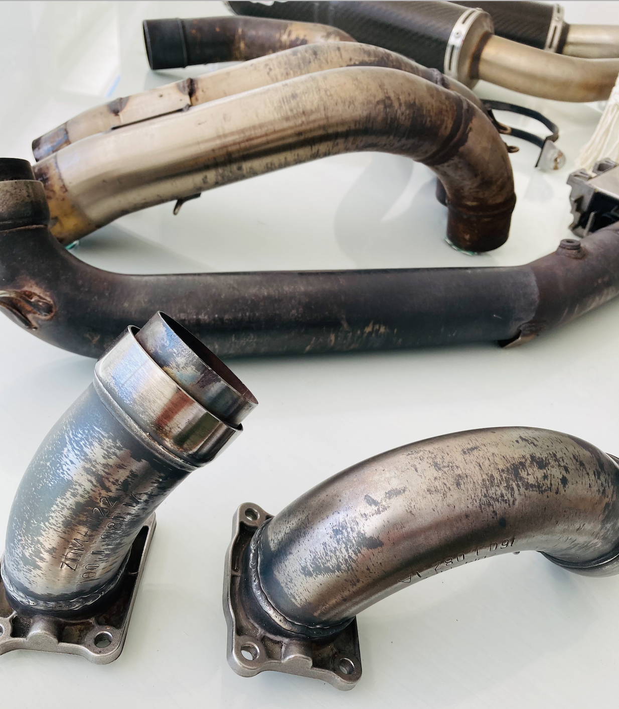

  1. Any tips as to how to bring back the shine back on these factory exhausts?
    Have tried a combination of Autosol, WD40, ACF50 (though the latter not very relevant to the process) with Scotchbrite on the manifolds but the results are coming in very very slow.

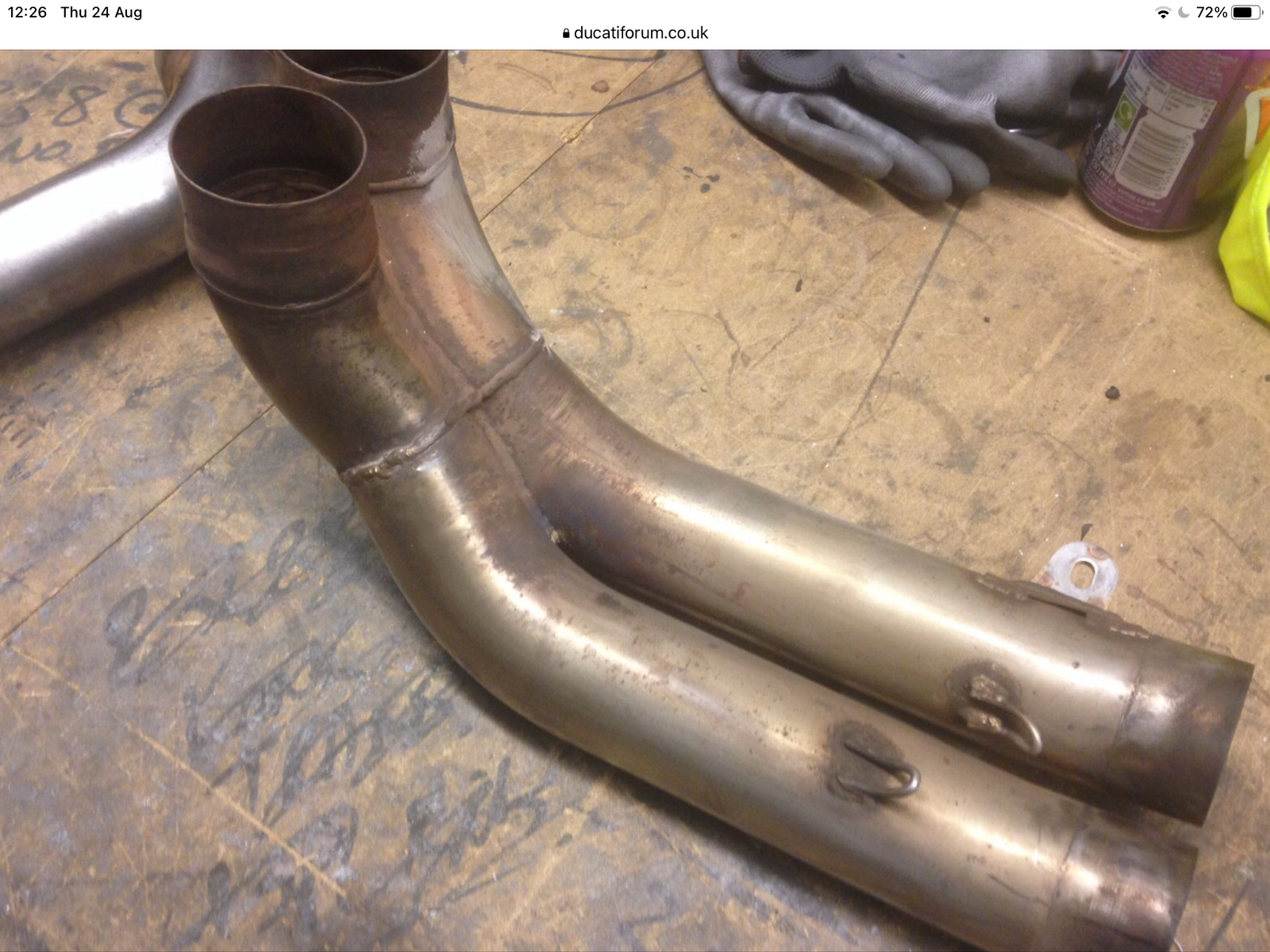

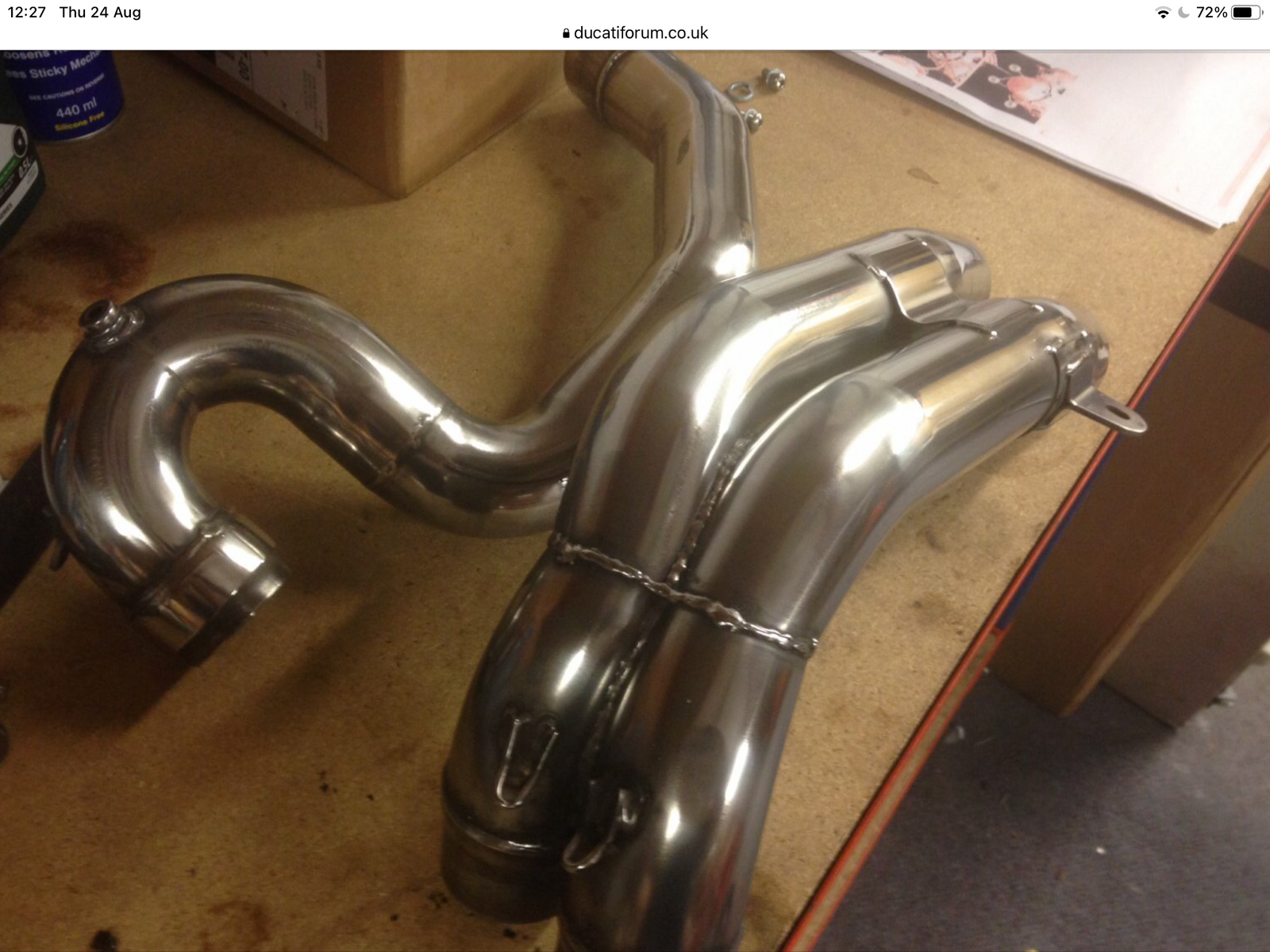

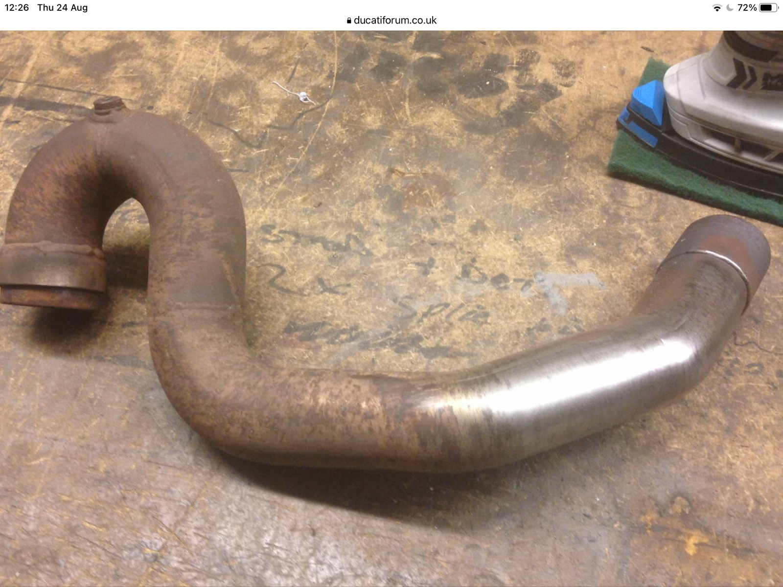

  11. Scottish brite on a small orbital sander. Within a couple of hours, you can achieve a very uniform satin finish.
    7D06062C-2BE2-47C5-8991-764299F67B64.png 679B01DF-D19F-46F0-8214-72CC5C90A1C8.png 9958057A-4349-4366-A512-18FB127B54E5.png
