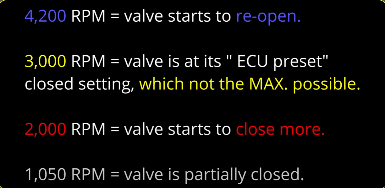

    How it works now... It is controlled from ECU, and ECU mainly takes throttle position for its opening.
    Example 1: Lets say you are at 2000 rpm and go foul throttle... it will open right away at 100%.
    Example 2: You go from 1000 rpms to 6000 rpm with low throttle... it will remain at 20-30% closed position.
    As i have monitor it, it closes foul only when you are closing foul at throttle and let bike roll with gear engaged.
    I refer the examples for better understanding :)
    sorry for bad writing.. not good at english:(

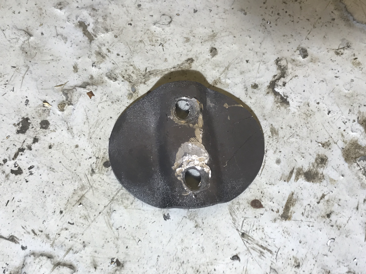

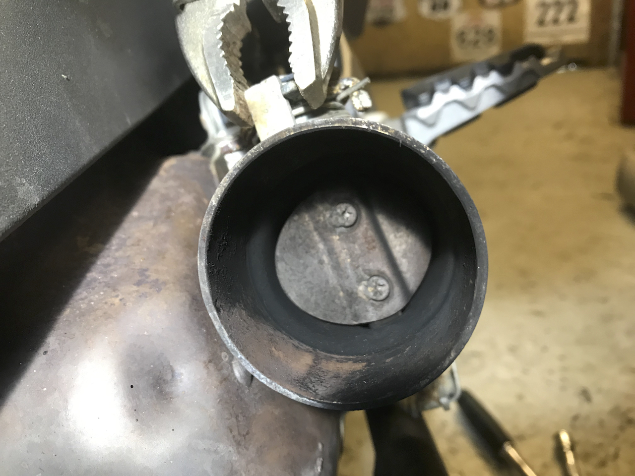

  12. Removed the flap on my 1260s after it got sticky and had power loss during over a few overtakes. Drilled out the rivets on the flap inside the exhaust pipe so the cable and mechanism are still there so the ECU still thinks there's a flap. No fault codes and not need to buy a healtech, or similar. I can't tell any difference in noise either. Win win.

    #12 mary hinge horse burger, Apr 17, 2024

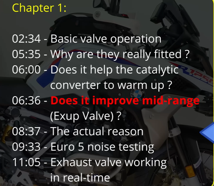

  17. The most exhaustive guide to exhaust valves. They use a GS as the example - is the concept universal? They suggest it is.
