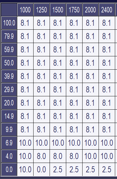

    The tuneboy trim files if you load them in the software will contain positive or negative numbers, this is an increase or decrease of fuel from the bikes normal fueling. Take the below up the side is throttle opening and left to right is RPM. upload_2022-8-19_10-15-50.png
    In that map it adds no fuel a 0 throttle when at 1250 RPM, but when you are at 9.9% open throttle at 2400 RPM it's giving the bike 8.1% of extra fuel. (don't ask me what those numbers actually represent)
    For it feeling groggy,make sure you are in 150 low to do this tuning as that has the linear throttle opening. Then maybe with the bike hooked up to the tuneboy take note of the throttle positions and RPM's you are hitting when you repeat the behaviour. Then adjust up or down the values in the squares in that area. Do it consistently then go for a ride and see if it's better. Make little changes a few at a time so you don't flood or lean the bike out.
