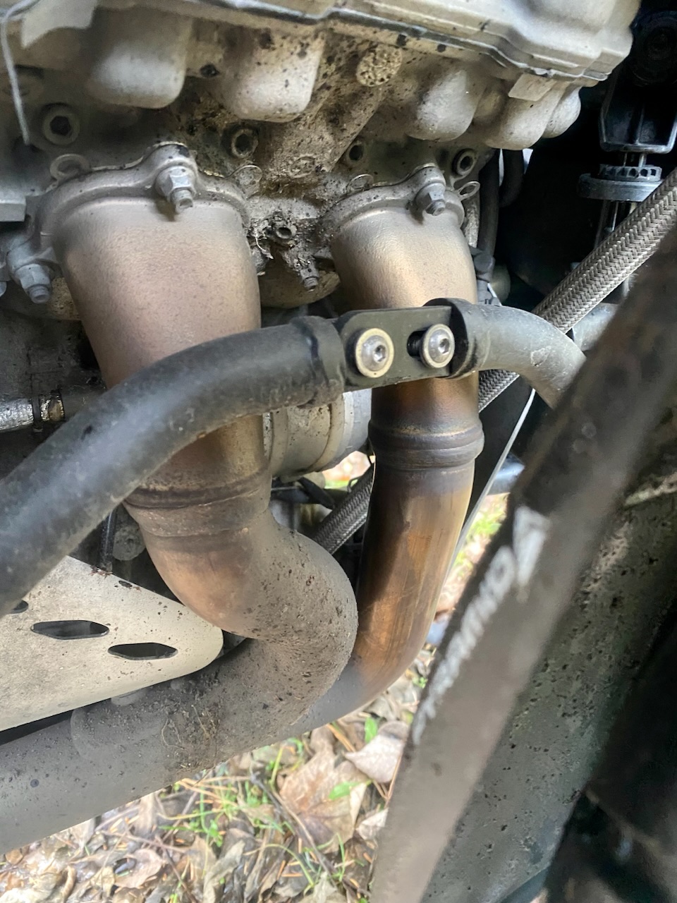

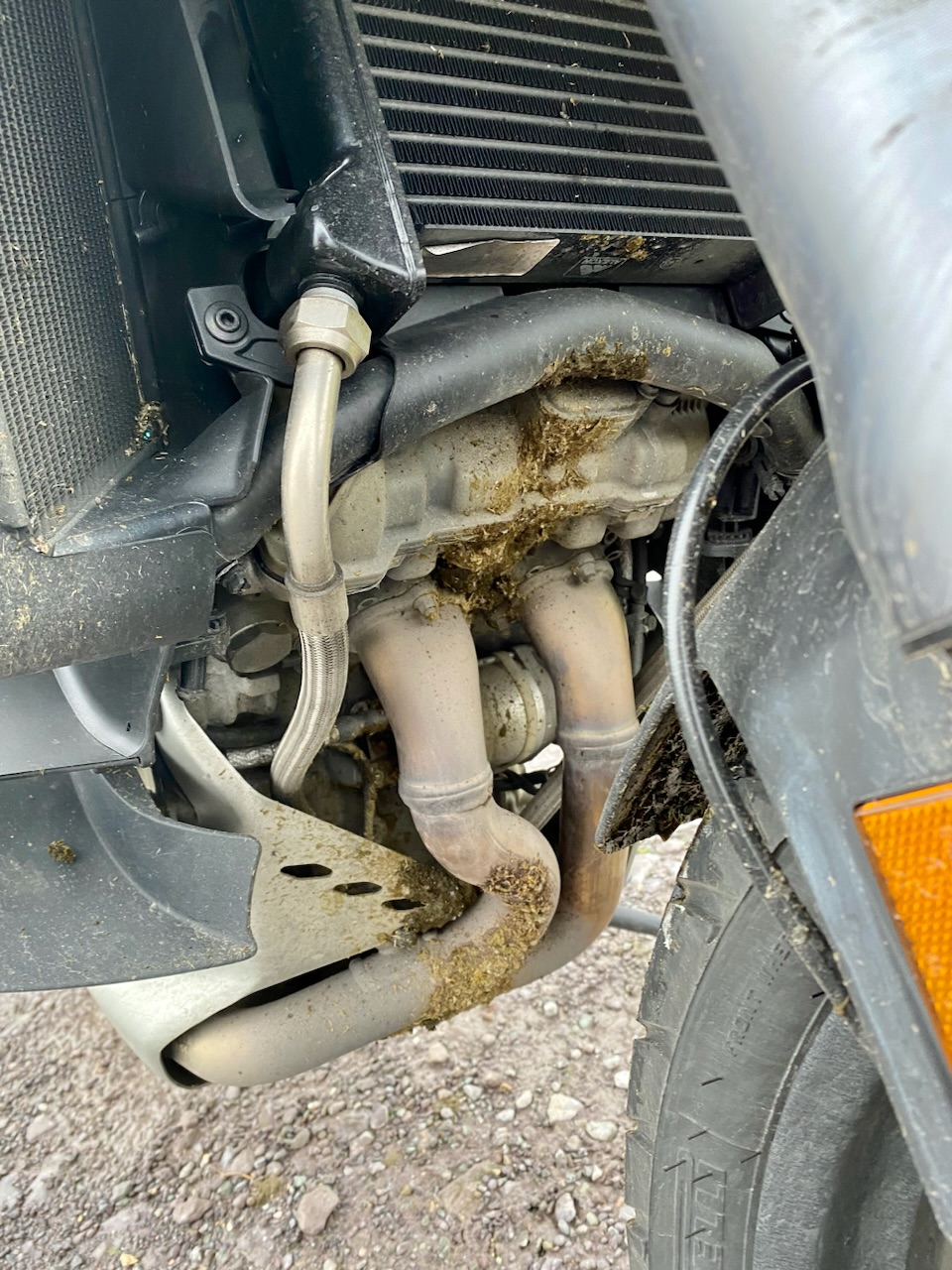

Copper coated ones. Im not familiar with the Evotech exhaust guard but am surprised the nuts need to come off the exhaust headers. FWIW I fitted a Pyramid Plastics fender extender to mine and that immediately cut out all the crap that otherwise was coating the front pair of cylinder heads and exhaust headers. Without With The black bits are my crash bars.
