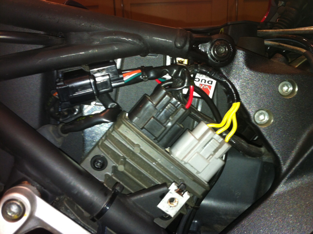

  3. Here's mine tucked behind the regulator on an MTS1200 ST. Works a treat and loses unecessary weight. Plug and play when I fitted the decat. Fast delivery and good service with solid reviews. image.jpg
