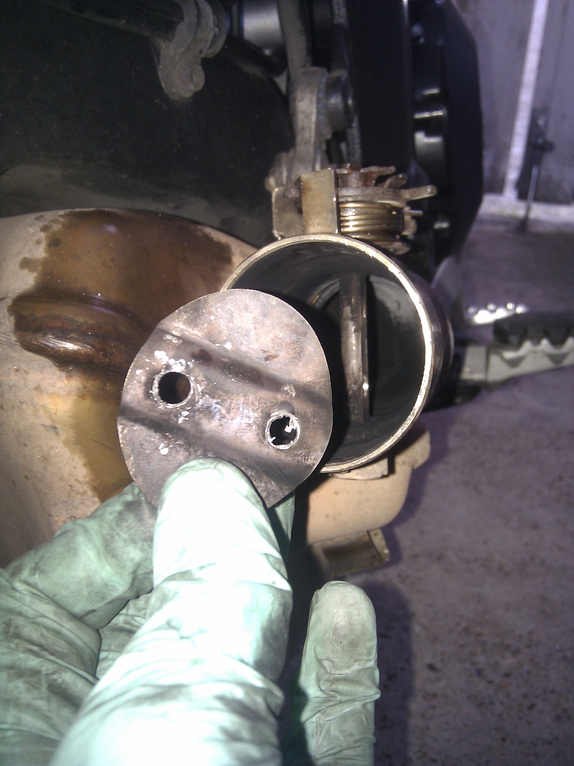

  10. Tonight I was in the mood to fix things...
    The exhaust valve, it's been jamming shut on and off for a few weeks. Finally pulled my finger out and sorted it. Broke a drill bit in the process, annoying :(
  11. Well done - I did the same two weeks ago = no more problems!
  12. reckon i will be doing the same before long
  13. It does seem to be the 'fix' of choice if you do not want to go down the de-cat route.
