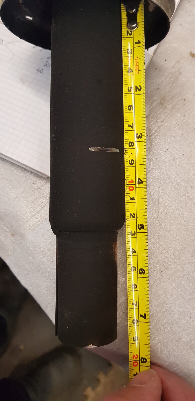

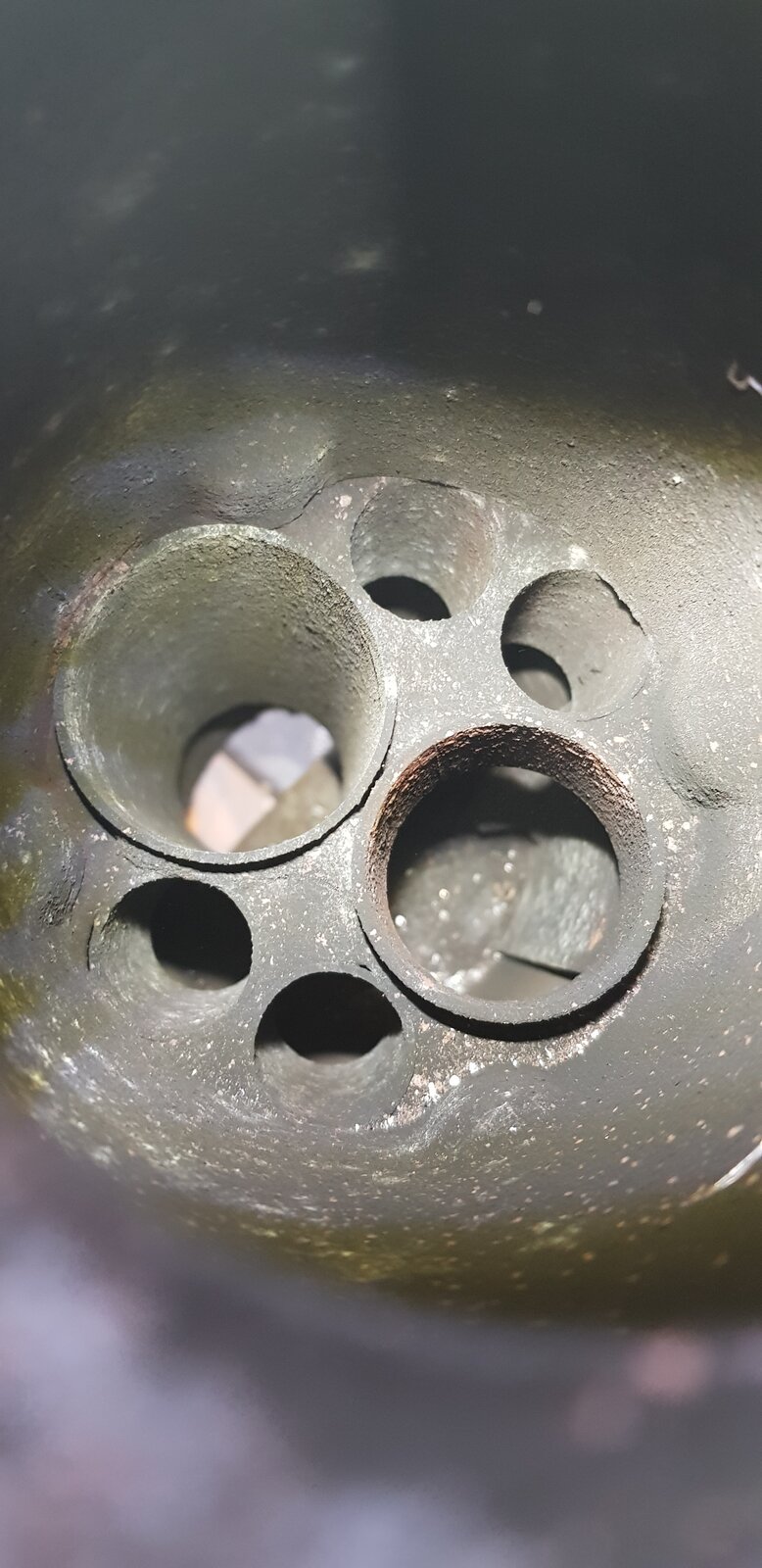

  2. You may be in luck as I have just cut open a standard exhaust and can take measurements for you if it helps? 20200412_164107.jpg

    Thanks that would be great. Is yours an A04 or A11?
    I'm after the internal diameter of the small baffle pipe where it comes out of the back of the exhaust and also the length of that small baffle pipe.
  4. I have an '89 851 with the original A04-B04 cans on, I have just measured the I/d of the baffle and it's 31mm. I can't measure length as they are spot fixed into place..
  5. It's an A04. Sizes measured tonight
  6. Thanks very much.
    Thanks, length and angle if that's possible although I can maybe work out the angle from my own cans with a little bit of cardboard and luck.
