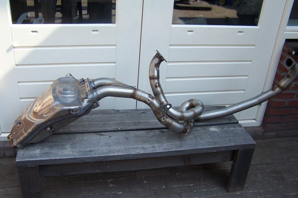

experts...will this fit a deep sump 999

  1. 50mm termi
    thanks

  2. Is the front pipe narrower around where the sump fits? Also will it fit the cast or ally swingarm?
  3. Isnt the 2 into 1 into 2 the better option ? is it 57 mm ?
    Im new to this but i think for b h p its better .
  4. hi
    it is a 2 into 1 into 2
    part number 96432903B
    I dont want a 57mm as I will lose mid range. with the mods im planning 50mm will flow enough.
    i was hoping someone would have previously had experience of owning one.
    I cant tell anymore about the system as its a pic the seller has sent
    #4 Phill, Jun 10, 2013
  5. Part no 96432903B is for a grey swing arm none deep sump model
  6. ahhhhh darnitt
    I take it its not even close to fitting on
  7. Not a chance, I had to buy a link pipe last year and they sent me a shallow sump one by mistake it took 0.2 seconds for me to realise
  8. cheers
    youve saved me a lot of pain and hair loss
