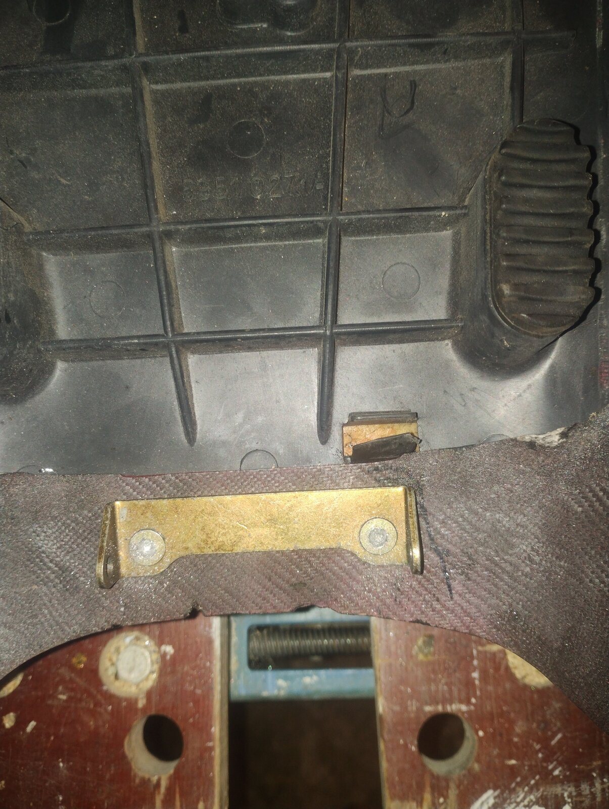

  1. Any ideas how to extract these, got extractors in there but the bolts are now spinning, suspect captive nut is spinning, it's a 996 seat , I'm trying not to wreck the seat unit as it may be of use to someone IMG_20241204_145045742.jpg e

  6. This,

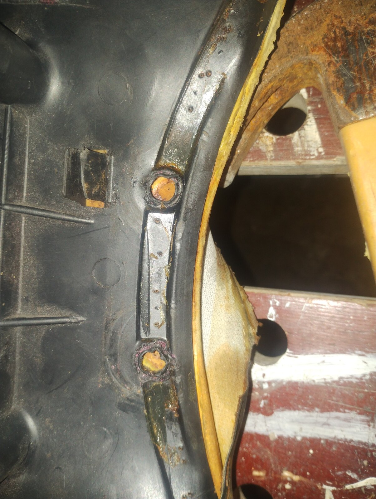

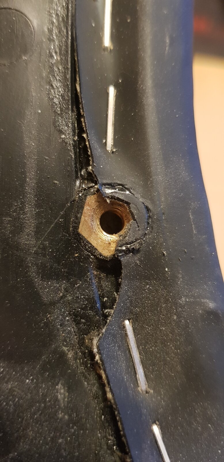

    is what you are looking at. The brass threaded insert is heat sealed into the seat plastic. If the insert is turning, I'm afraid you are in for a difficult time. Andy

  10. If the seat pad is fubarred, you should be able to access the back of the brass insert by removing the pad cover. Worth a look if the seat unit is carbon. Andy
  11. I agree, if the captive nuts are spinning there isn't really a good method to get them out. I've had the captive inserts spin in an airbox (the air tubes on a 999) and in the end I had to just tear out the insert with force and violence (and harsh words too)...then tidied up the fcked area with a new insert held in with epoxy. The repair is invisible (and would be in your case too), and should be ok as long as the new bolt isn't overtightened...

  13. Bolts jammed solid , and were rounding off so started drilling then put the extractor in hoping the bolts would come out, all I achieved was to free the captive nuts, will try a saw blade on the bolts if not may see if they'll prize out or weld a bar as Nasher suggested

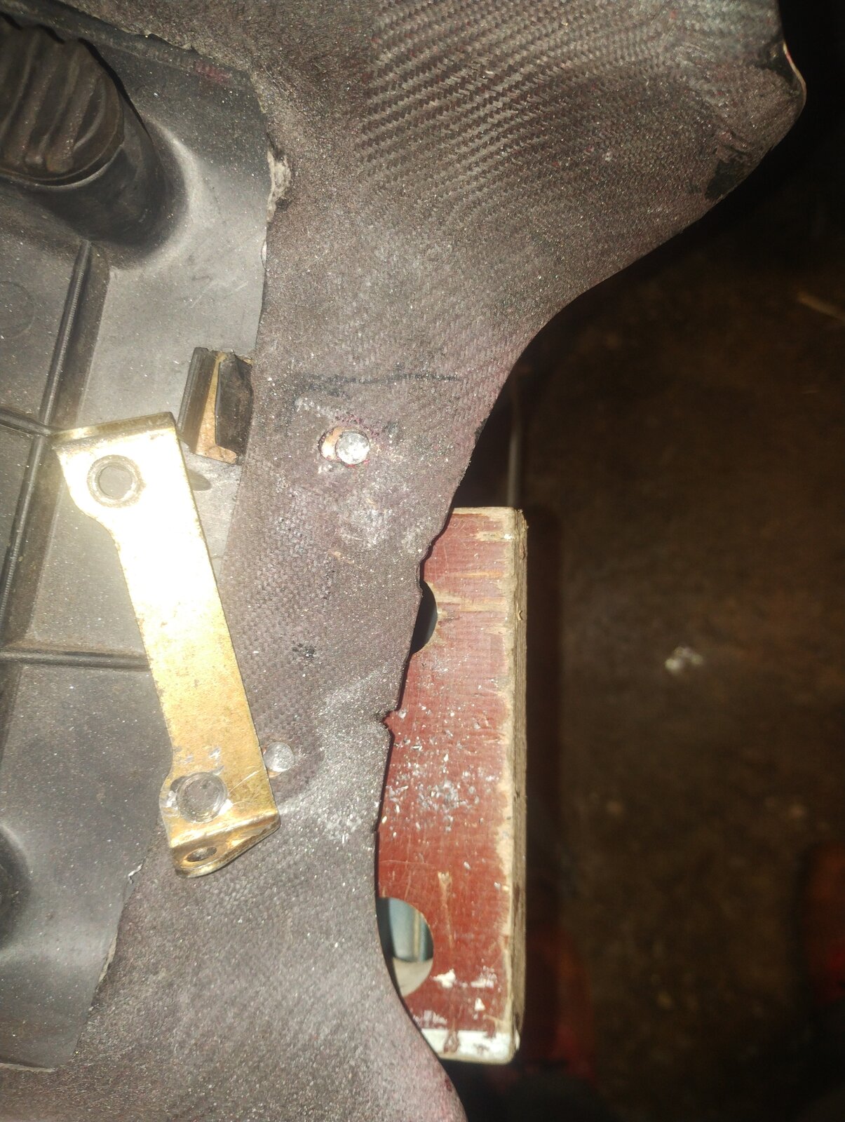

  16. Successful, managed to get sufficient resistance to the bolt spinning to drill the heads off

  18. And punched the captive nuts out
