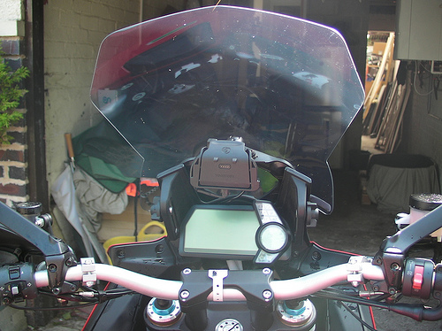

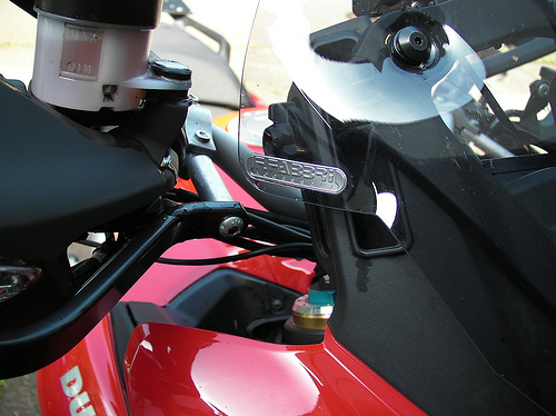

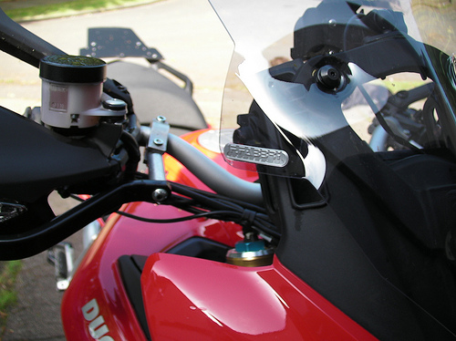

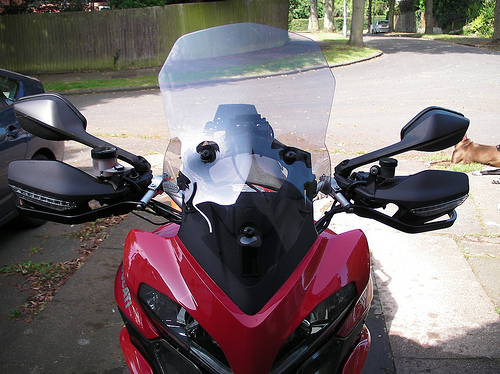

  1. I replaced my screen with the F.Fabri touring screen in June and have done over 2,500 miles since then down to WDW etc so I thought I would post up a review of my thoughts.
    The bad points:
    • The fit isn't perfect, the bottom mounting hole had to be forced and really needs to be made larger
    • I have bark busters and the only way to stop these hitting the winglets at full lock is to have the screen at full extension - it looks big fully extended.
    • Delivery took three weeks
    The good points:
    • It is much much better than the stock screen
    • Its cheap
    • The light smoke looks better in my opinion than the clear stock screen
    • Those winglet things really work
    • No buffeting up to 50mph
    • 50% Reduced buffeting and noise compared to stock 50mph +
    • Much less wobble than the stock screen, this is really good for me as my improvised high up sat nav mount is now much more stable
    The screen is about 2 inches taller than the OE version and up to around 50mph there is no noise or buffeting, I now ride with my flip front lid in the up position to 50mph. The downside is that when I was in Italy and it was hot, I could get no moving air in to my jacket as the winglets reduced the air movement over my chest and shoulders. Some pics below (click through to Flickr for the full pics):

  2. Been waiting for someone to post a review of this, thanks. Will standard hand guards clear in lower positions?
    #2 markyd, Jul 31, 2012
  3. I'm sure Fabrri would have product tested their screen with the standard guards fitted - they are a reputable company and make good products
  4. Fits fine with the standard handguards, its just the bark busters where there is a challenge.
