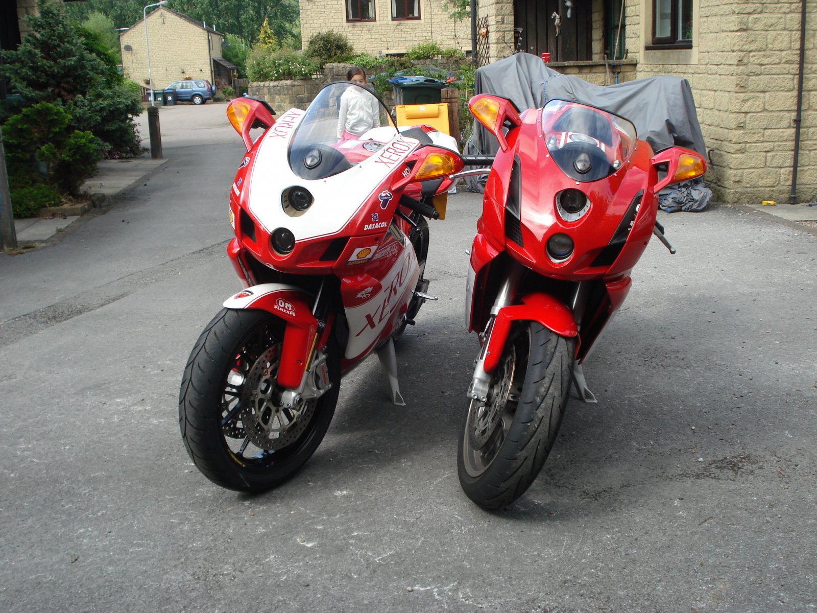

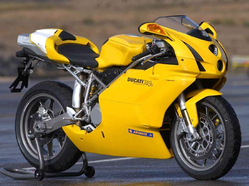

The obvious difference to me is that the earlier bike has vertical slashes each side of the headlamps. The lower section of the slash forms the intake for the air-runners to the airbox and the upper portion vents through the fairing.The later bike lacks the upper slashes and only has the air-runner intakes, as in @900streetfighter 's pic. The other really obvious change is red rather than silver frame. Personally, I rather like the red frame and I'm sure the deeper sump is of benefit but the fairing changes and black swing-arm are aesthetically just different, not better.

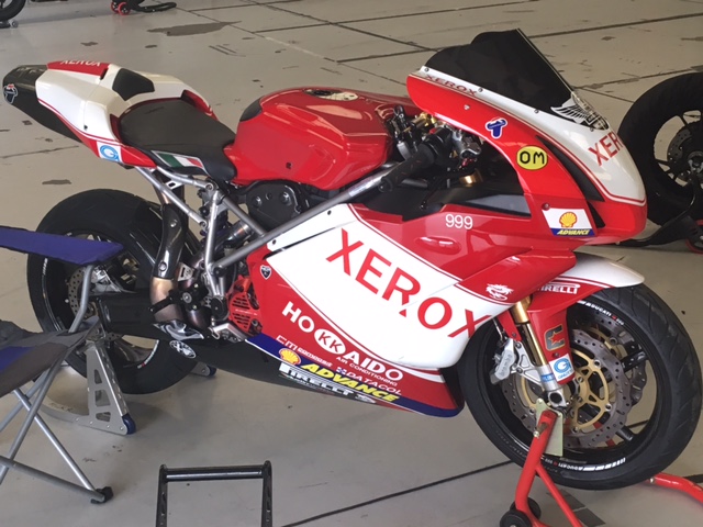

would not put to much into that the latter bike is a 999r Xerox pic to show difference on the noses and screen

Me too... Mine's an 05 but I like the extra vents in the earlier front end. Fits fine with the later side panels - you'd barely notice where it doesn't quite line up. cheers, Dom
