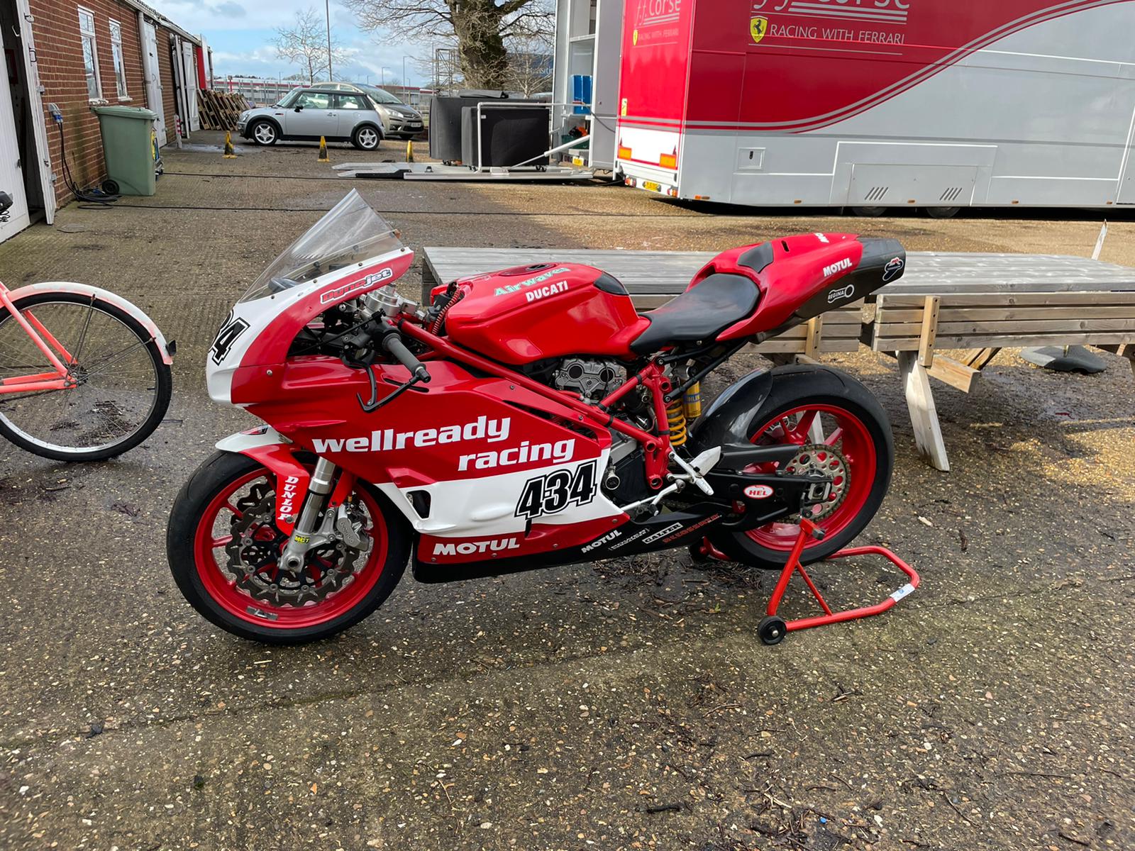

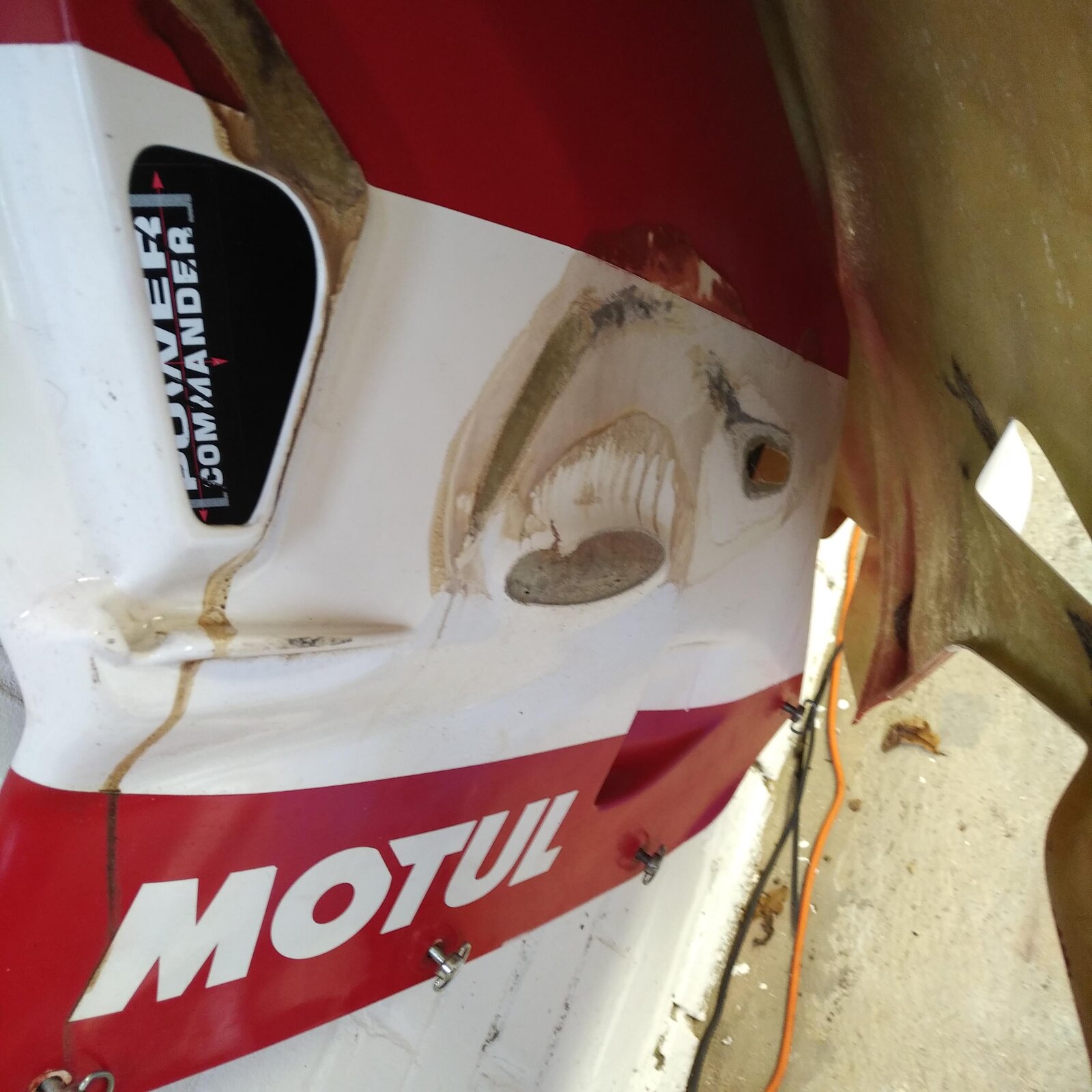

  1. so finally going to get my track hack fettled and need to tend to a hole in the fairing after an unplanned excursion last time i was on track. so far i have bought this
    https://www.amazon.co.uk/gp/product/B01B85H5C6/ref=ewc_pr_img_1?smid=A3QLTTR5CX4IKS&psc=1
    the hole is about the size of a tennis ball

  2. Good quality duct tape. Put it over the hole on the outside which will make the repair far easier as it will help to keep the shape/ curve. It also prevents raised height of the filler.
    I'd get prepaint cleaner to wipe over the surfaces before spraying.
    I recommend high build spray filler which you use on the final surface prep, prior to paint.
    Lastly don't attempt this job unless you are in a warm room. The chemicals wont work properly, the filler will crumble and dry too slowly, and the paint will bloom (finish looks milky).

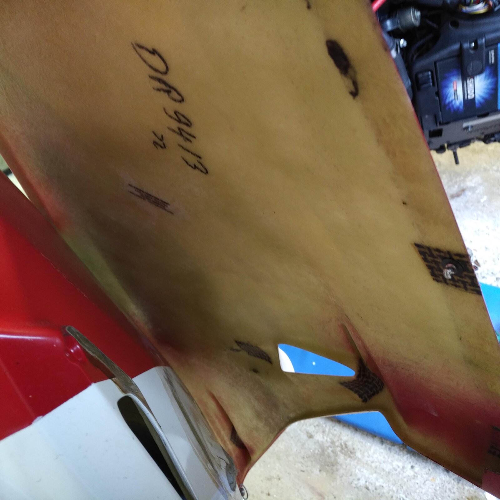

  6. I used a carbon fibre patch on the inside face and automotive grade body filler to fill the outside surface. The filler held up and stayed in place but didn’t take the paint particularly well. I realised too late, I should have used a sealer before undercoating. Andy

  9. That will be fine for the hole. As said, tape up the outside and do from the inside.
    Get plastic bumper repair filler.
    Don't bother trying to paint unless it's at least 15 degrees.
