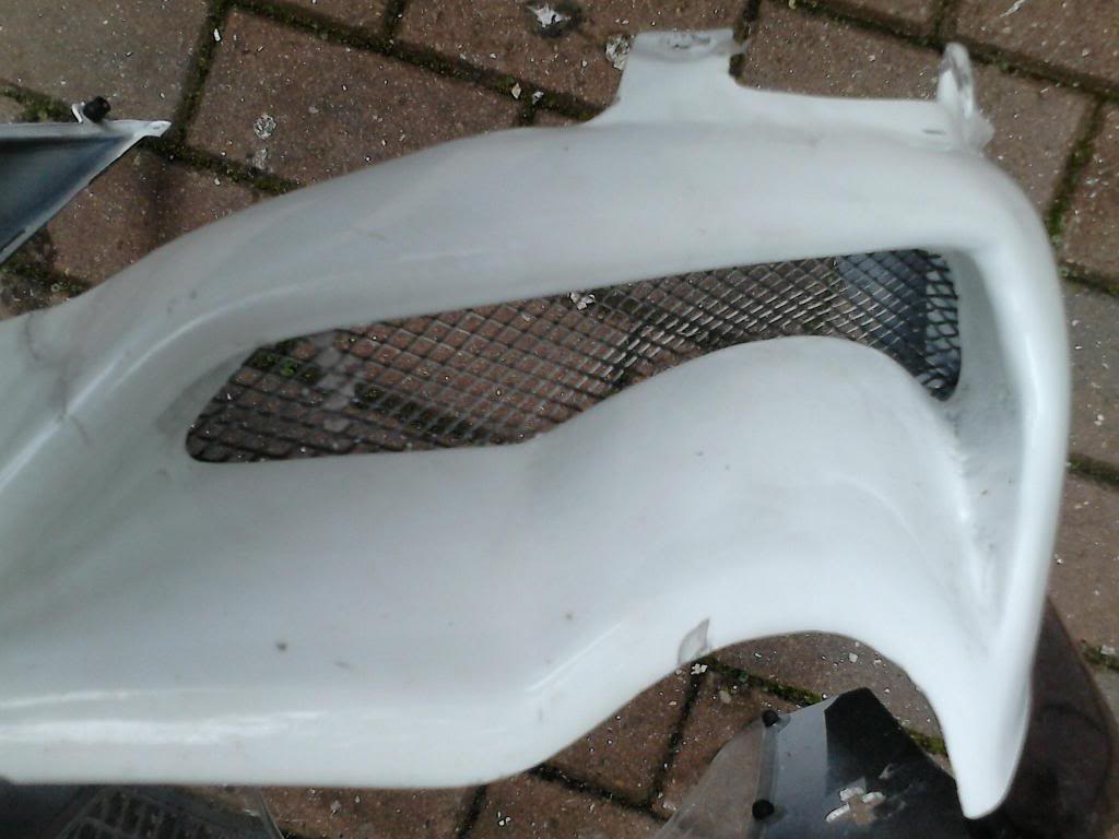

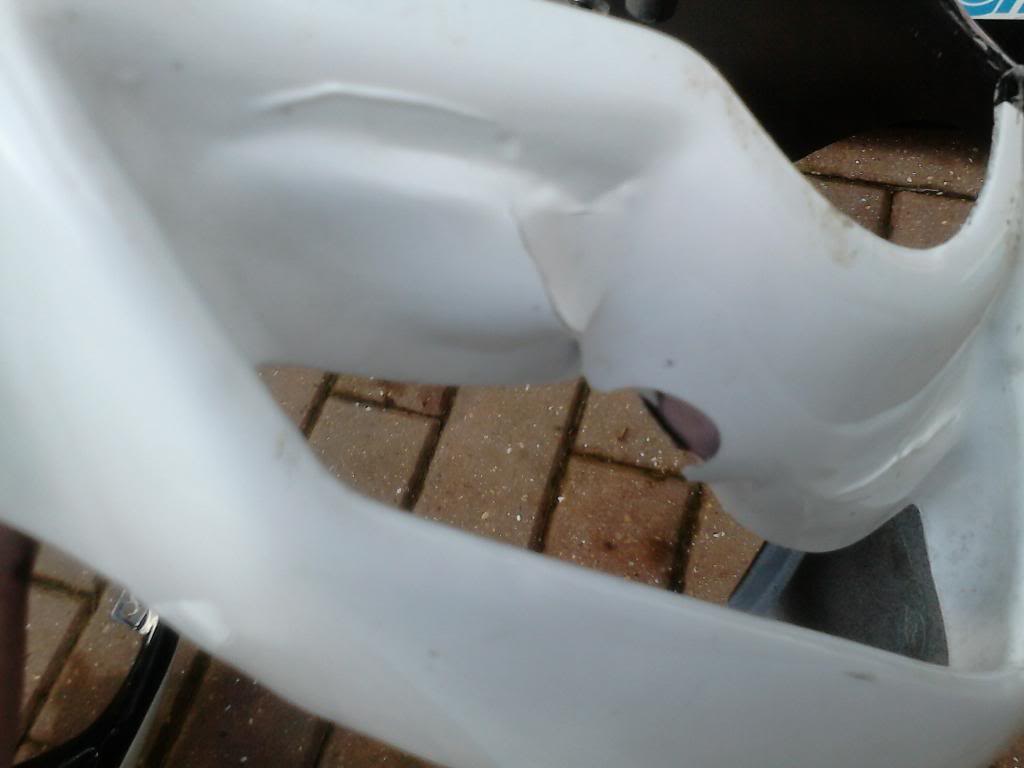

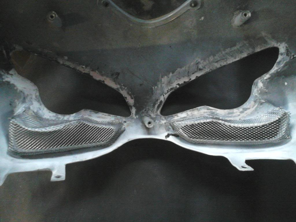

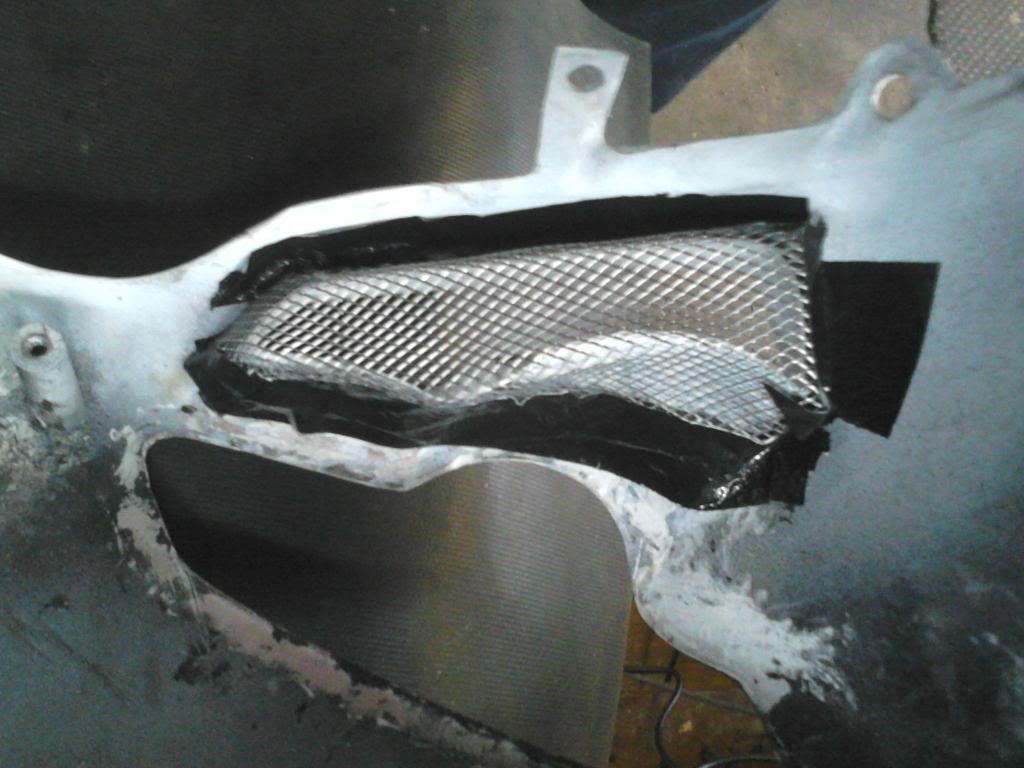

  5. Okay so this is what I need to repair. I dont have the piece thats missing from this one, so i'll have to make something up
    This is part of the front air scoop and appears to be blistering paint. Im thinking, scrape it off and respray it with some cheap paint after filling i down a bit for good measure

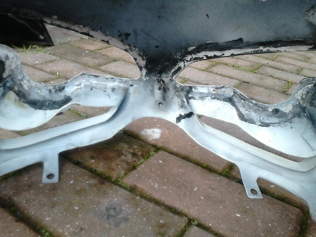

    Cover the bottom ones with gauge, Epoxy resin and some Duct Tape

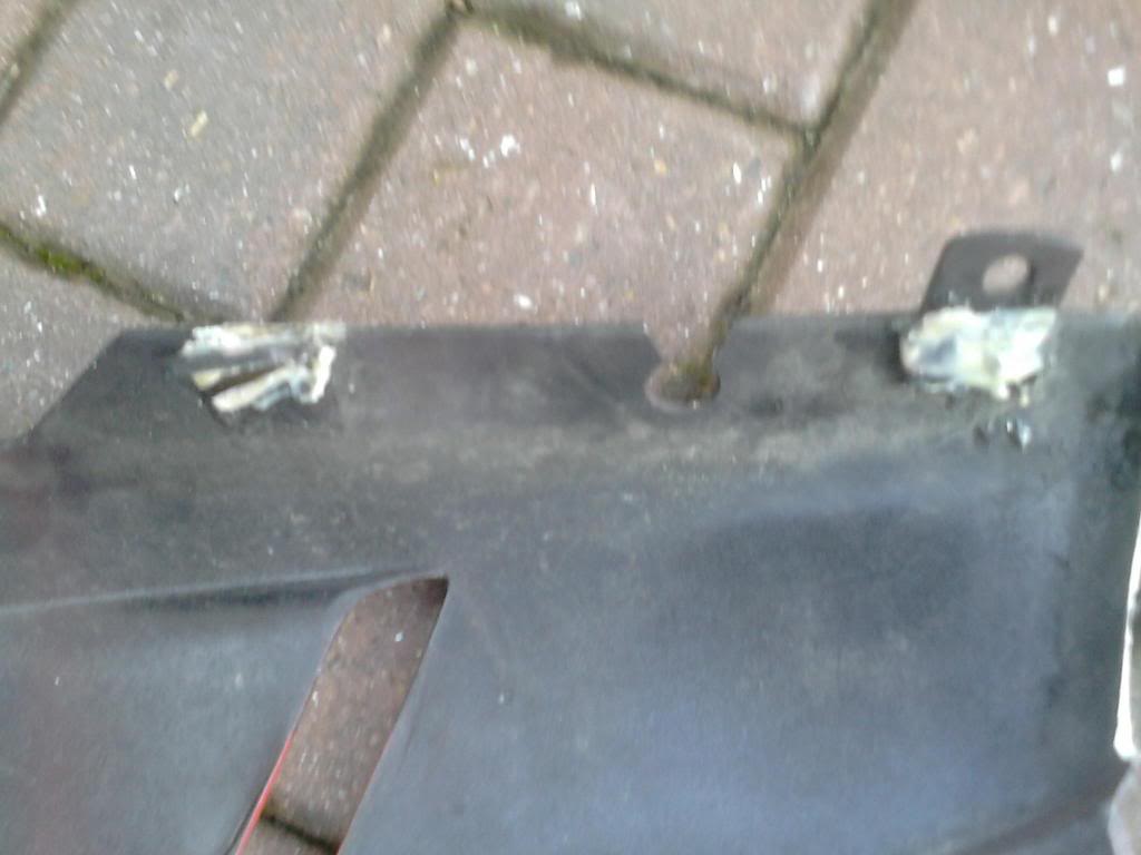

    and finally rebuild all three of these lugs (may cut the ones on the old (crashed) belly pan and attach them
    Any suggestions would be greatly appreciated

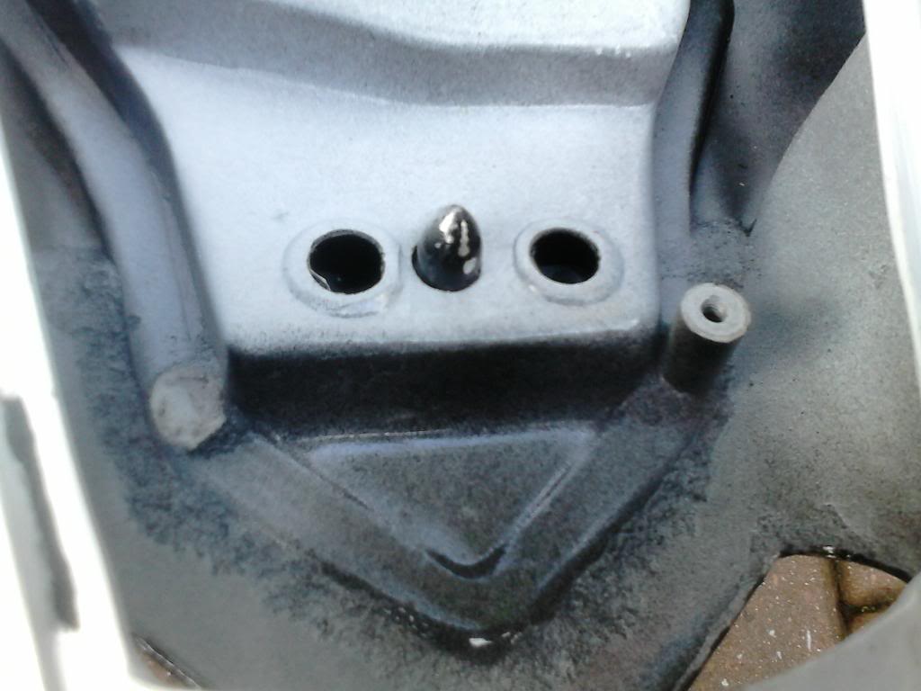

  6. Well the tabs on the belly pan were a massive lost cause. Not enough material to secure the taps whilst putting on the correct fasters. Then the only one that wasn't broken fell apart on me too. I've decided to try and get a bolt through the tail to help secure the rear light. Thankfully, this will be hidden by the seat cowl. Going to tidy up the inside of the nose fairing this afternoon and try and get some gauze over the air scoops
  7. I'm going to start to repair a whole host of fairing parts I have accumulated in my garage once I get my track bike going, hopefully this weekend ready for Donnington on Tuesday! I have welded some fairings very easily and using some Q bond is great. You can also make up tabs etc using alloy and glue that to the fairings, never through old bits away as you can use it as welding rods by cutting pieces off or using it as brace material.

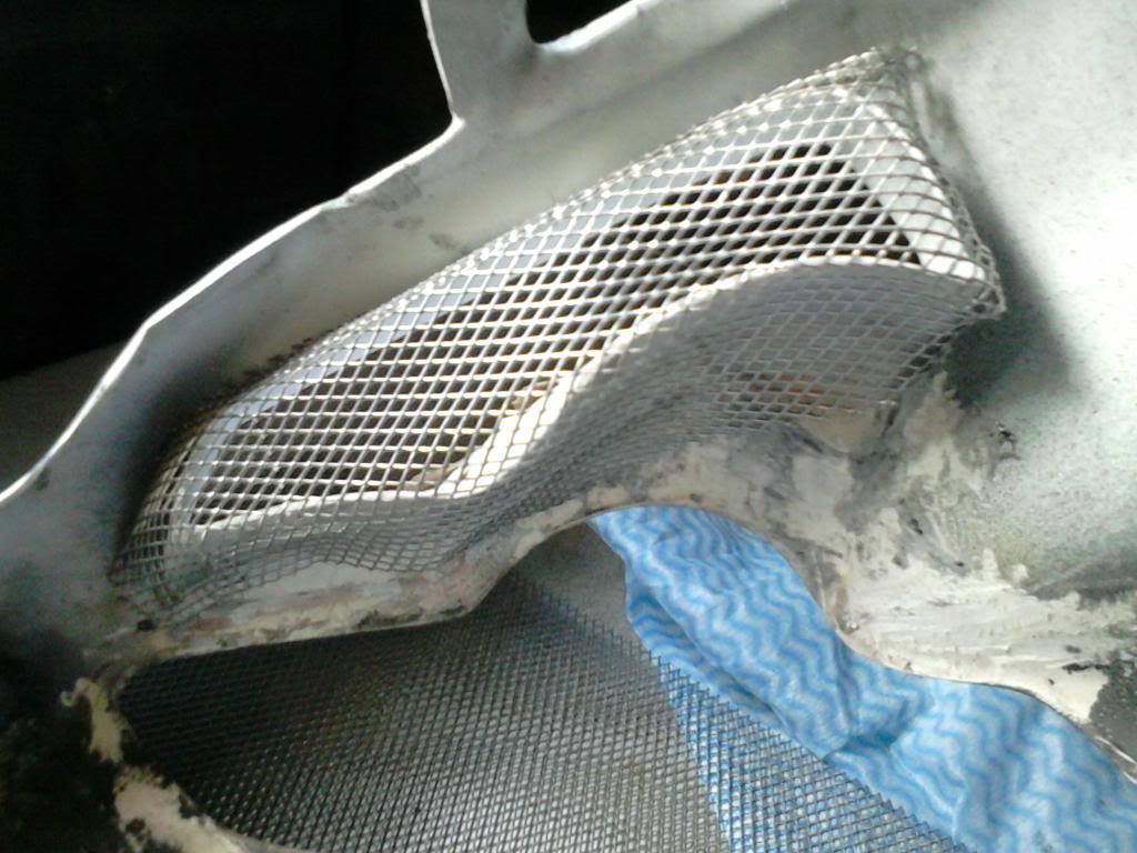

  8. Gave up on the belly pan. The lugs were beyond repair...or should I say I had a much easier alternative
    Building up the ram air covers. Didnt have to be too neat, just practical really
