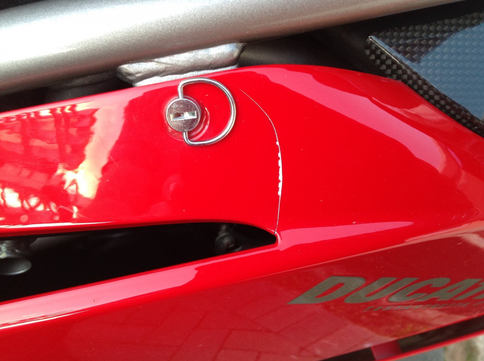

  15. The same happened to my 749 at speed it was like riding a spatchcocked chicken , but got away with only a small crack .....I'm looking to get mine repaired and painted then probably sell the affected fairing in try and source/ buy a new one ....if any of you can point me in the right direction that would be cool ..I'm in Shropshire , and it's a 2004 ... image.jpg
