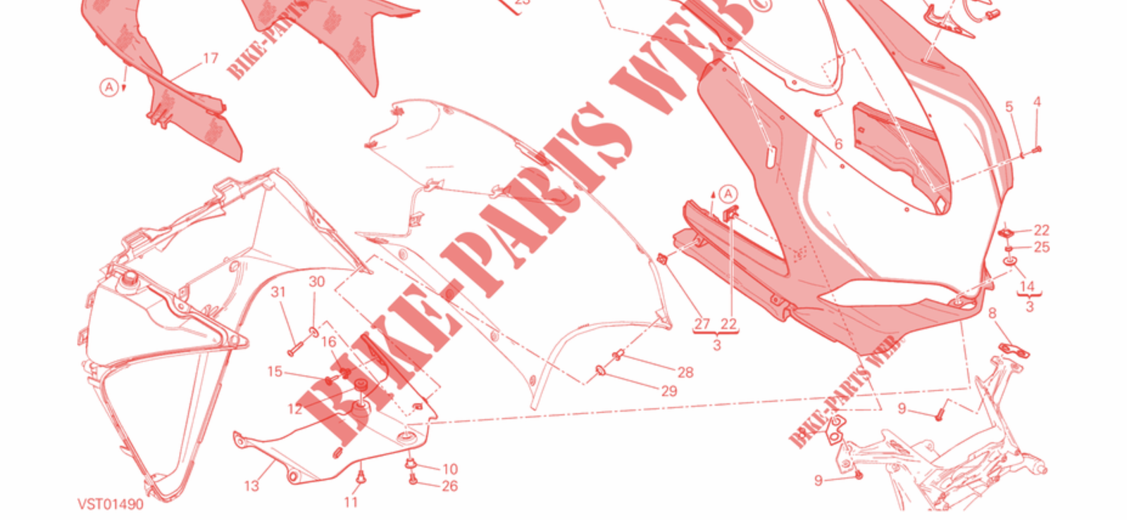

  1. Panigale R Gen 2 but I think it’ll be the same across the 1199 family. Near side upper side fairing is secured at the top of the front edge under the nose cone by small, long screw which seems to fix into a well nut? Mine has ‘disappeared’. Is it an ordinary well nut? Nothing seen on the parts diagram.

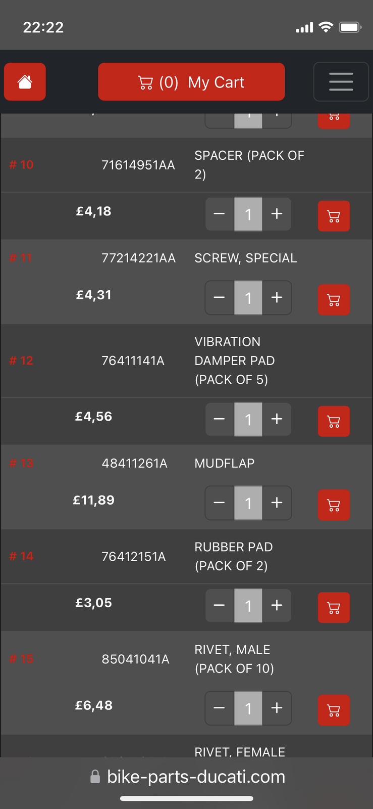

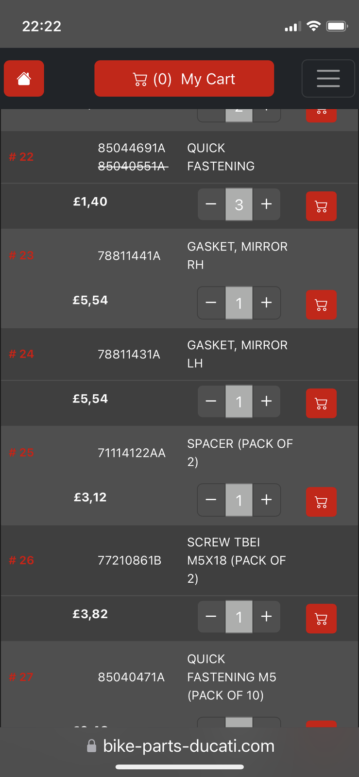

  2. Items 10,14,22,25 & 26?

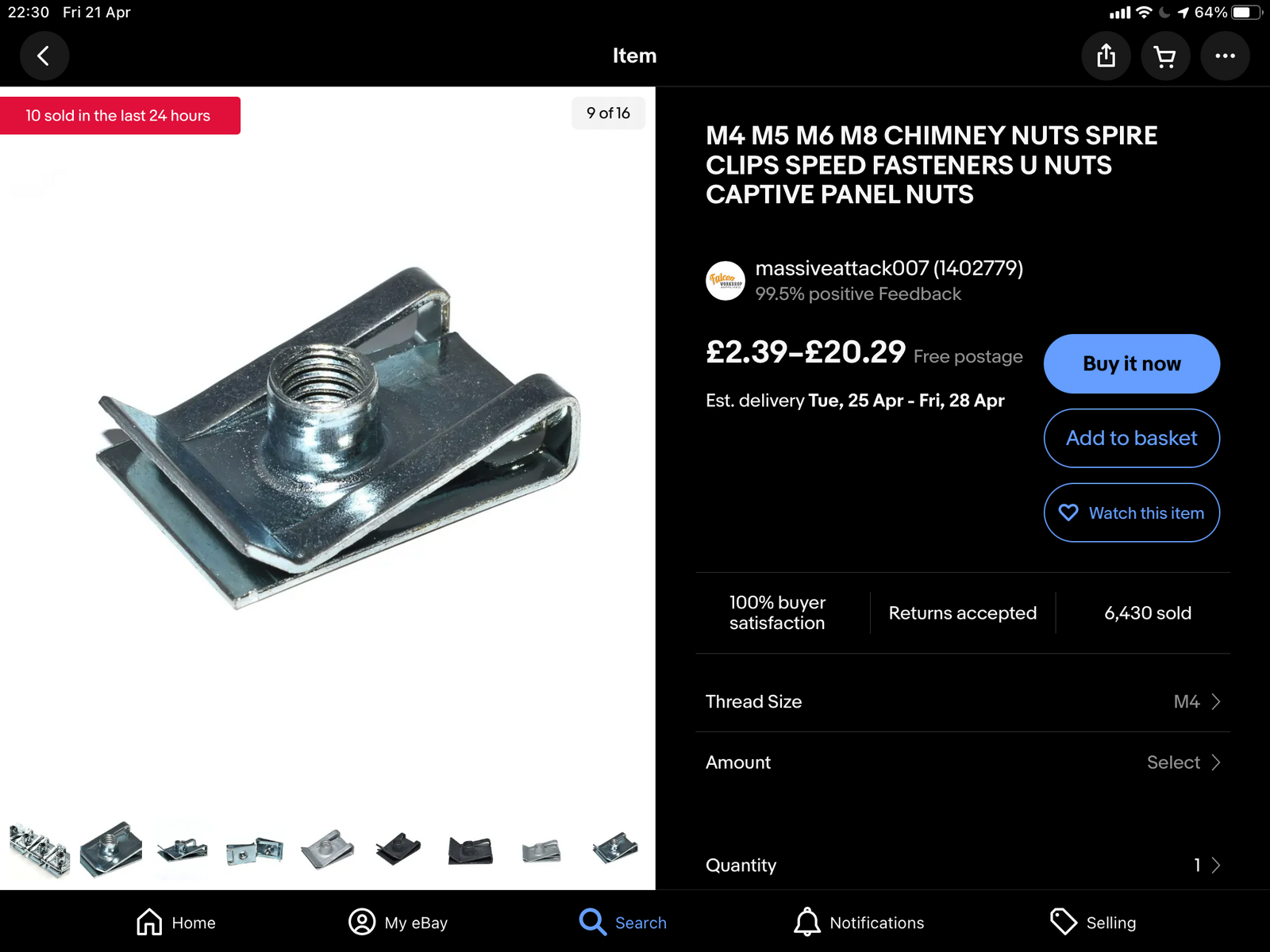

    Buy a couple of these and grind a taper onto that bolt. Makes refitting the side panels a doddle.
  4. I was looking at the fairing section, but the parts are listed in the “headlight fairing” one.
