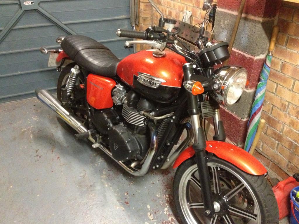

    Ps......why have you posted a pic of a Triumph?
  3. Hes showing off his courtesy bike.
