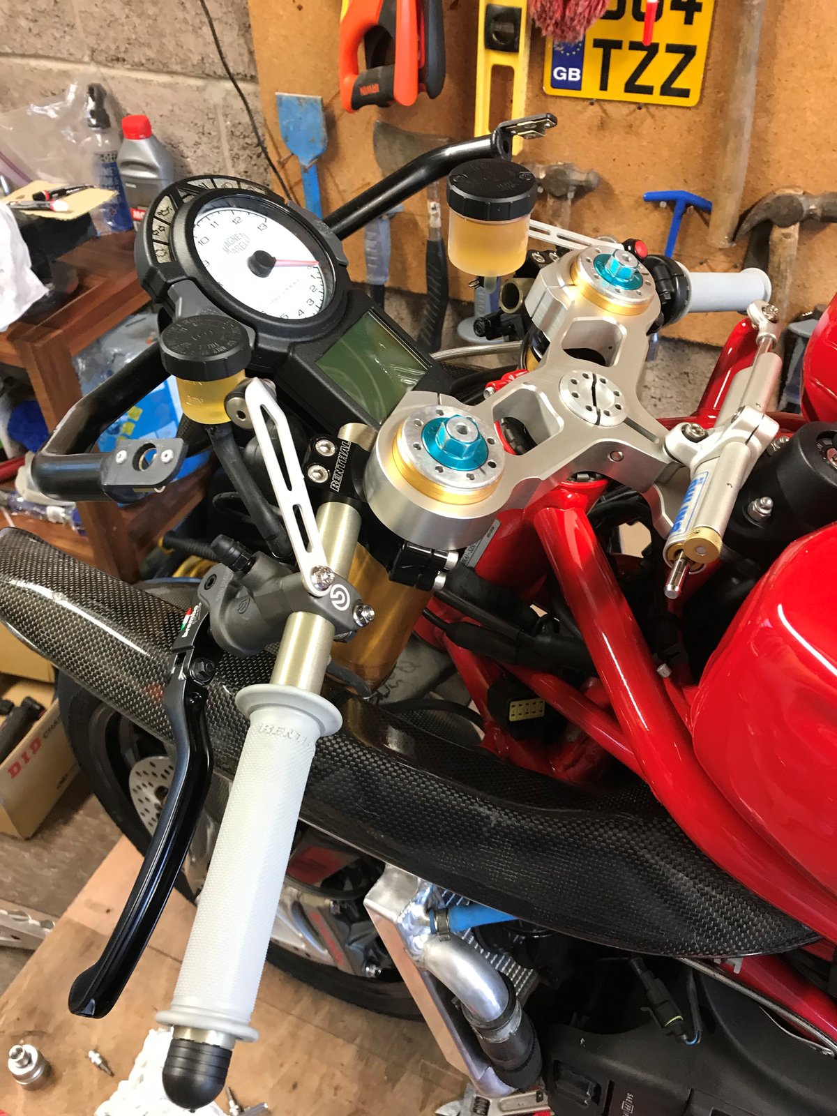

  1. I've finally got around to sorting out fitting my RCS brake and clutch master cylinders. So far I'm happy with them :upyeah:
    My question however is if anyone had a solution to retaining the fast idle when the OME switch gear has been removed. I find it useful for warming up the bike on track so would like to retain it in some way. Any suggestions?
  2. Convert to single cable and early 996 type throttle with the fast idle button.
    Or use the fast idle cable with a choke type push/pull button
  3. I understand @andyb done the first mod and may have the parts available
  4. That was what I was thinking, seemed to be the simplest solution to me.
