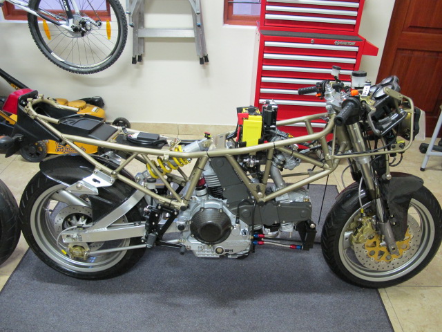

  4. My, what a clean garage!

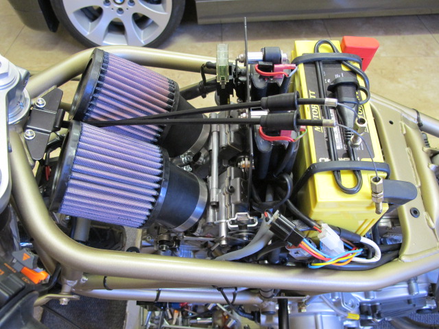

    Regards
  6. Had a pull cable manufactured to fit the OEM Throttle, works great.[​IMG] Couldn't convince myself to fit that MOTION PRO JUNK...[​IMG]
