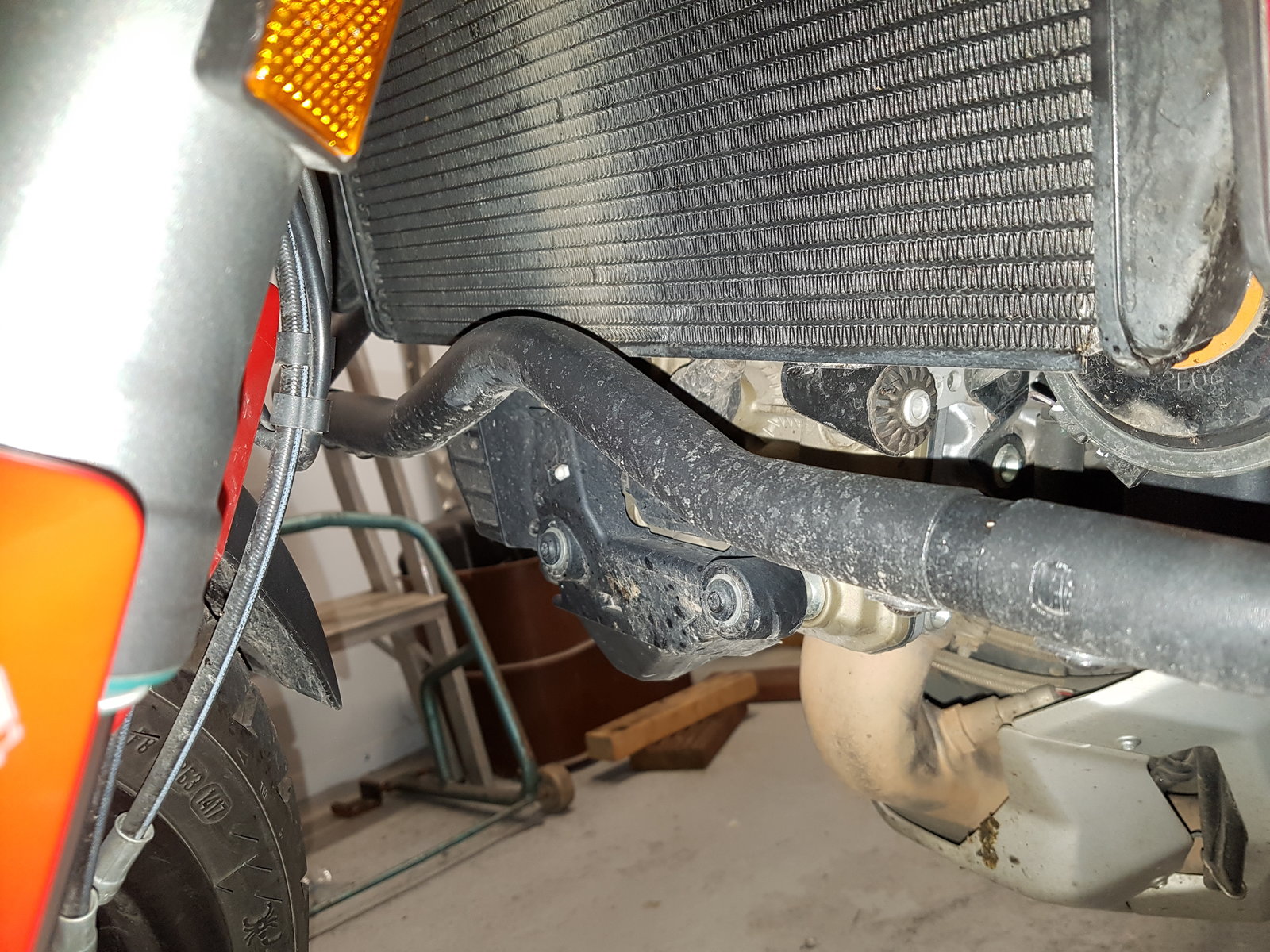

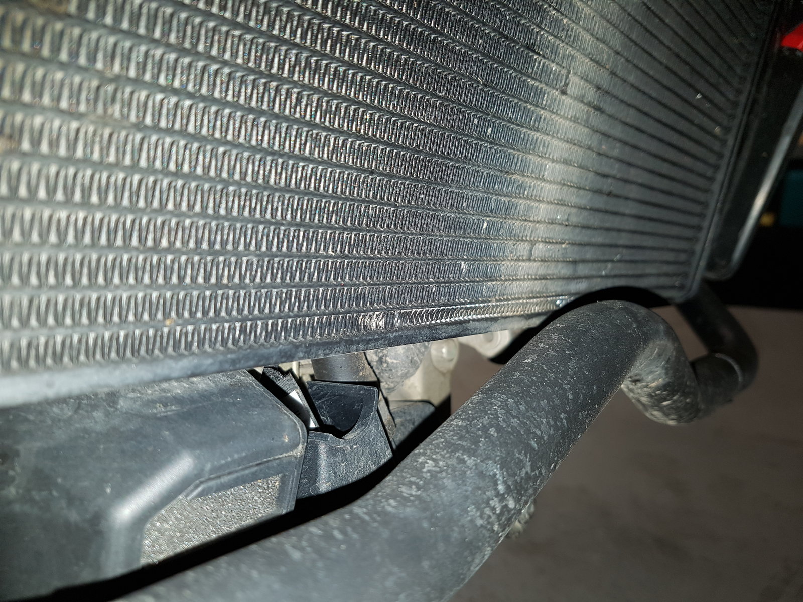

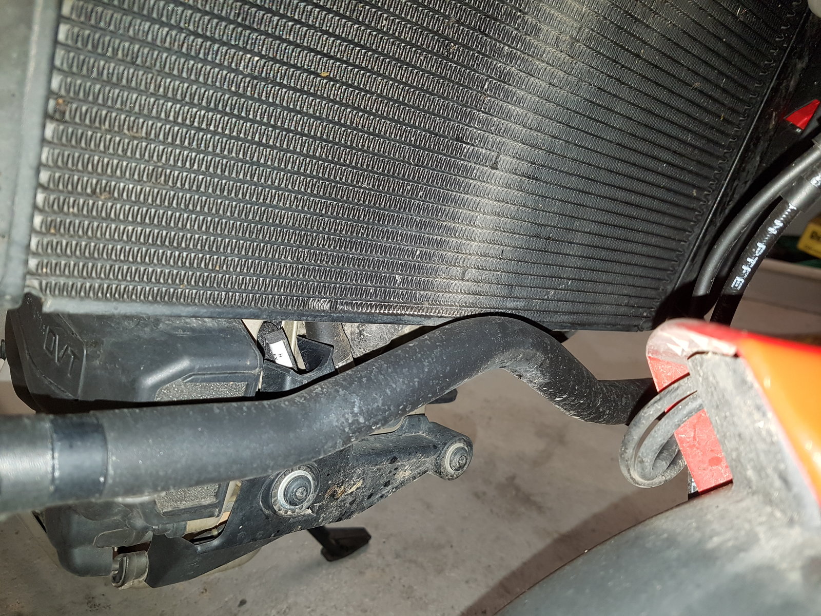

  8. Anyone reading this thread please do not buy the Givi engine guards. I have warned them that i was going to slag them off as they have constantly denied that the Givi engine guards are flawed. I purchased a set from ebay for £144 2 months ago. They came from Italy in a lovely heat shrunk plastic bag. I opened them & started to fit them using the instructions supplied. I thought it strange that the cross bar that goes below the radiator did not resemble the pictures on the ebay advert. I continued & fit them as per the instructions. I went on a ride & braked hard at a junction & heard a strange noise from the front of the bike & the bike bike seemed to veer. A guy i was riding with said stop. We pulled over & the rear or the front mudguard had hooked up over the cross bar. It damaged the bottom cooling fins of the radiator & broke the lugs of the fender extender. I contacted Givi UK who said (we do not talk to customers so talk to the dealer who sold you them). This i did. This went on for weeks. Eventually I re-contacted Givi who said in these strange circumstances we will deal with you direct, i had already told them that i nearly crashed the bike, due to there incompetence in supplying the incorrect parts in there kit. They asked me for photographs of the problem so i sent them pictures of my damaged radiator on a brand new bike. I received this reply.( It is clear that on page 3 of the fitting instructions that it says to remove the rear section of the front mudguard. In no part of the instructions does it say to refit this part) I replied that to remove & not replace the rear part of the front mudguard was to render the mutlistrada a sub standard motorcycle. I do not usually swear on this site but basically Givi UK told me to fuck off. I now have a 2017 multistrada 1200s with a busted radiator & broken front mudguard. I also after posting this await in abaitment the Italian mafia coming knocking on my door. Bring it on arseholes. See pictures included

  12. Exactly wayne. I am fucking busted on this. Not usually so uptight but the wankers did not even acknowledge there was a problem. & to say trash your front mudguard to fit these bars is a joke.

  16. Look at the photo,s & do the math. Brake hard & the rear of the front guard hooks over the cross bar. Now the bike suspension comes back up but the mudguard has hooked up behind the cross bar. Not knowing this i now steer the bike & the rear section of the mudguard is resting on the bottom row of the radiator. Turn right & left a few times & the radiator bottom fins start to fold up. I was at the Wensleydale cheese factory in Hawes when i was pulled over to the fact that my bike was slowly becoming trashed by the Give bar problem. I except that shit happens but when a big company like Givi tell you to fuck off & multiply then i am at war. Bastards.

  18. Hi folks I had this happen on my multi fitted with the touratech bars fitted by the dealer am about to discuss with them
  19. It happened on my dvt with touratech bars also - 2 up with luggage under heavy braking.- it would have been easy to heavily drop the bike when it became trapped, luckily I didn’t.
    I discarded the extender and upped the front preload nut
    It’s a shit design and Ducati should tell you to do this modification.
