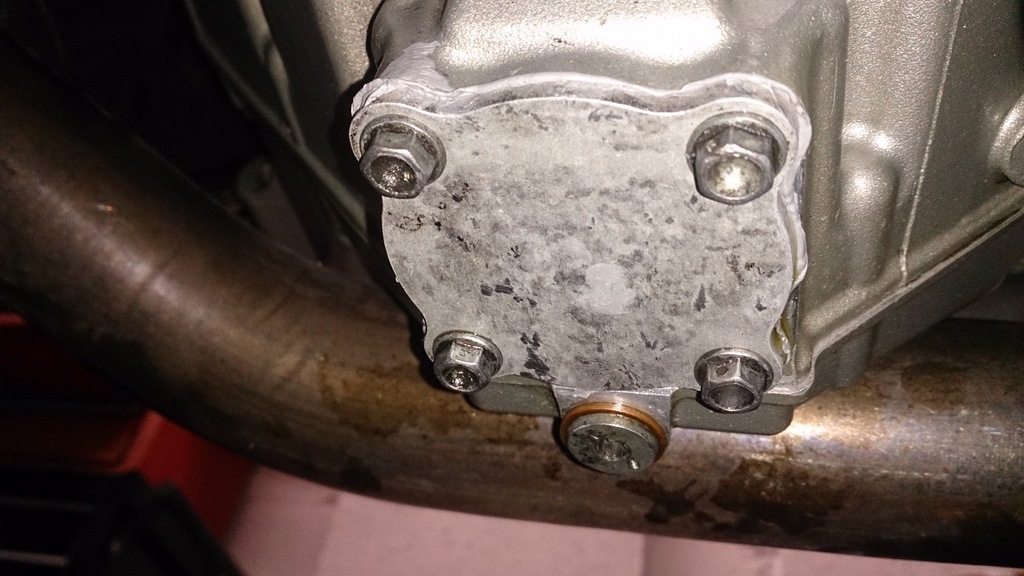

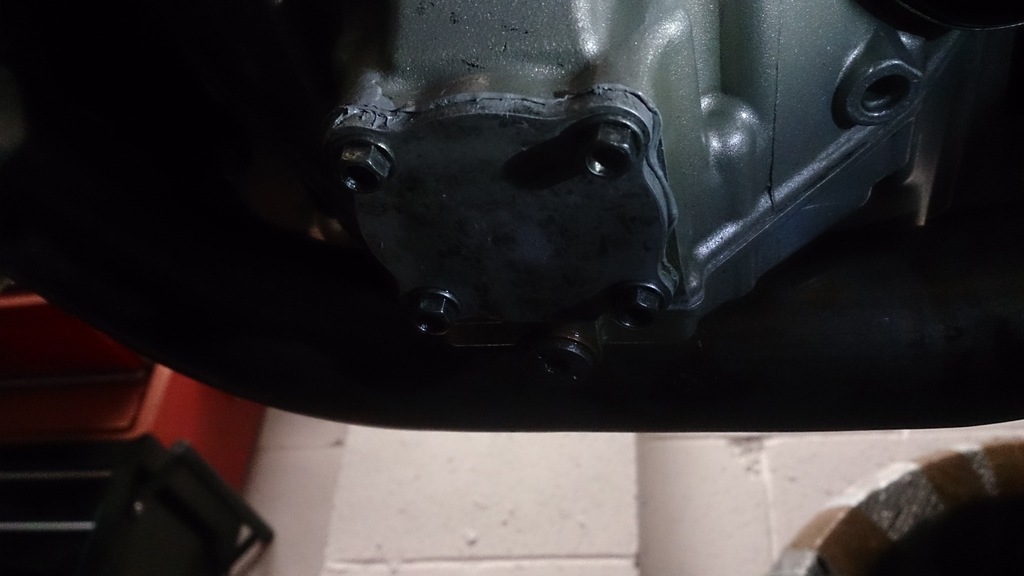

  1. Well yesterday I was doing some work on the bike and noticed I had an oil leak on the square filter cover for the oil screen. I tweaked up the bolts and covered the seam with gasket, ran the bike to temp and it was all good.

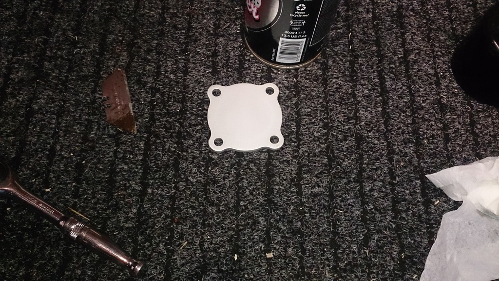

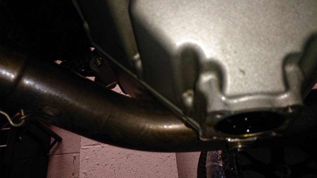

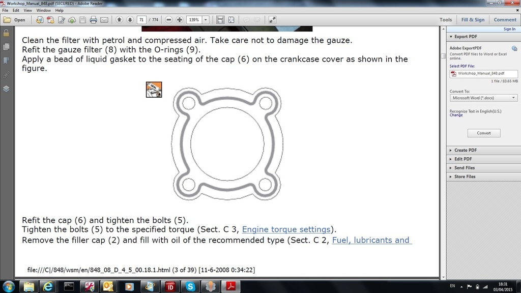

    Stripped all down, cleaned up the surfaced, re-gasketed it as per Ducati's diagrams from user manual and fired it up... oil went EVERYWHERE.... Nah, just kidding :) Oil at the moment didn't go anywhere or everywhere, it seems to have hopefully been a good fix, a good job and the sump and all the bike is dry and content...
    I'm scared to link any pics now ! But there's the before/during and the after...
    I've once again run it up to temp and apart from a drip where I was filling it back up with oil (yes I did remember to fill it before running) my blue roll underneath the bike is completely clear of all fluids.
