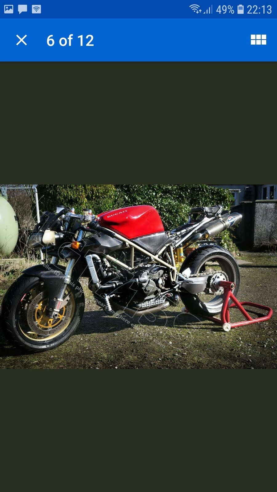

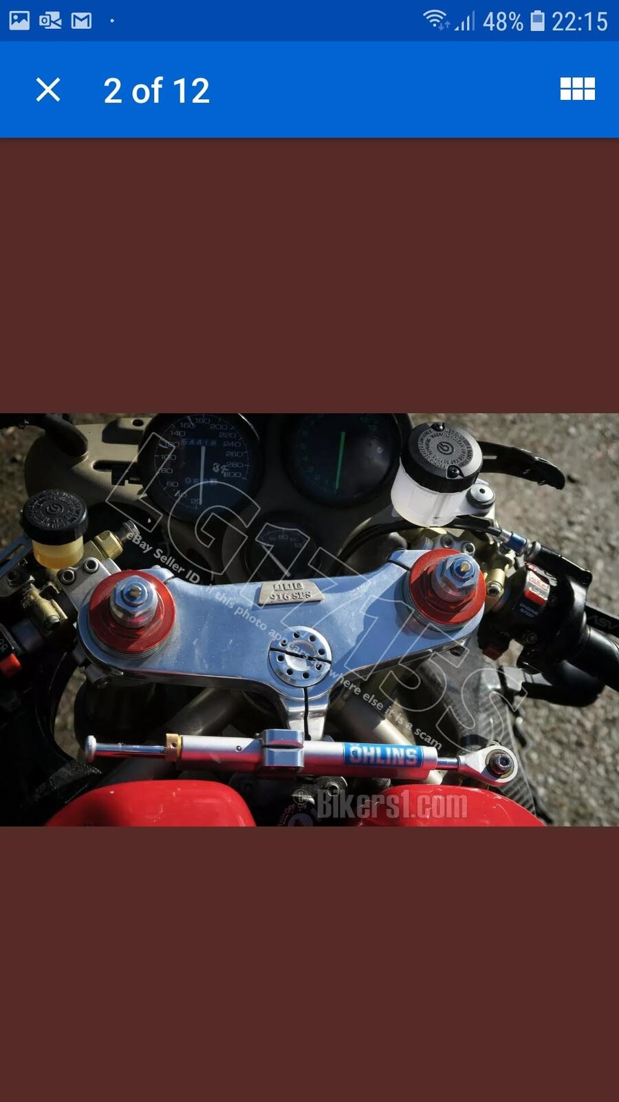

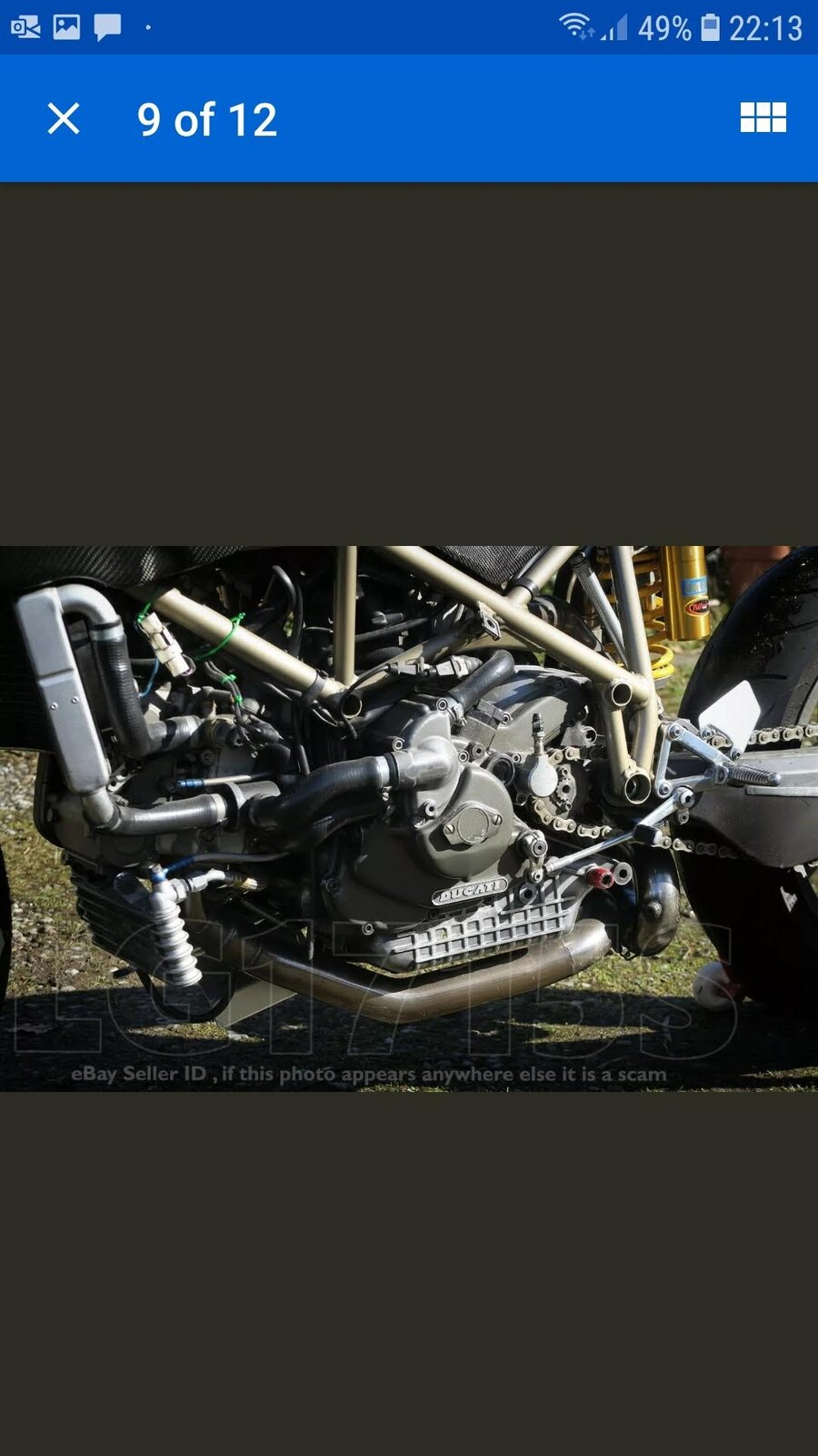

  14. Last few pics are when I took a chance and bought her as a basket case off ebay.
  15. absolutely stunning bike. Love that.
  16. Very nice pics and nice to hear you salvaged an orphan and brought her back to the fold.
    I bought my tatty 996 SPS at auction and have slowly brought her back to presentable with new paint and a thorough engineering check.
    Now that she is running sweet I have decided to have the engine out for a thorough refurb, just to ensure she performs well for the next twenty years.
  17. I really enjoyed rebuilding my 996sps, its a great feeling knowing you gave it another 20 years life.
