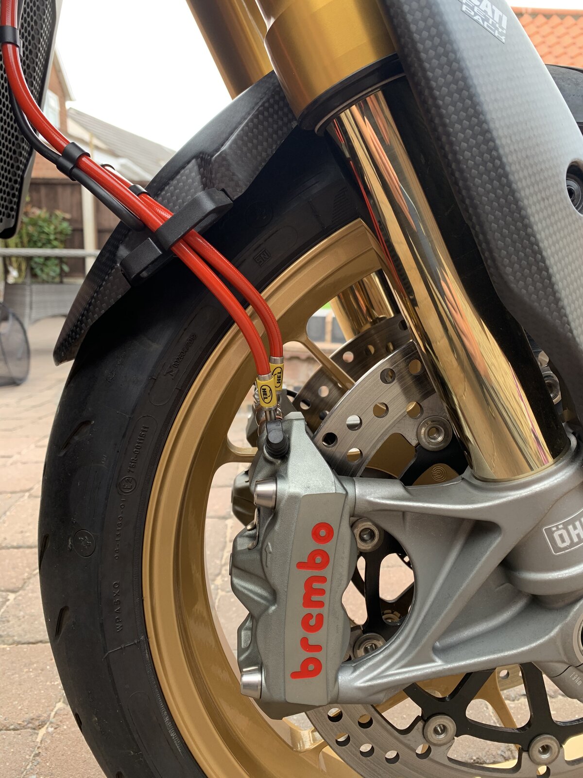

  4. I just upgraded my hyper 939 to M4’s. Gone with an RCS19 master.
    Full new set of HEL custom lines due to banjo fittings being on the opposite side. It was a faff but the lines cost me nothing as HEL used my originals as pattern
    Guys at HEL were HELpful and they understood my less than professional sketches for banjo angles and hose length mods
