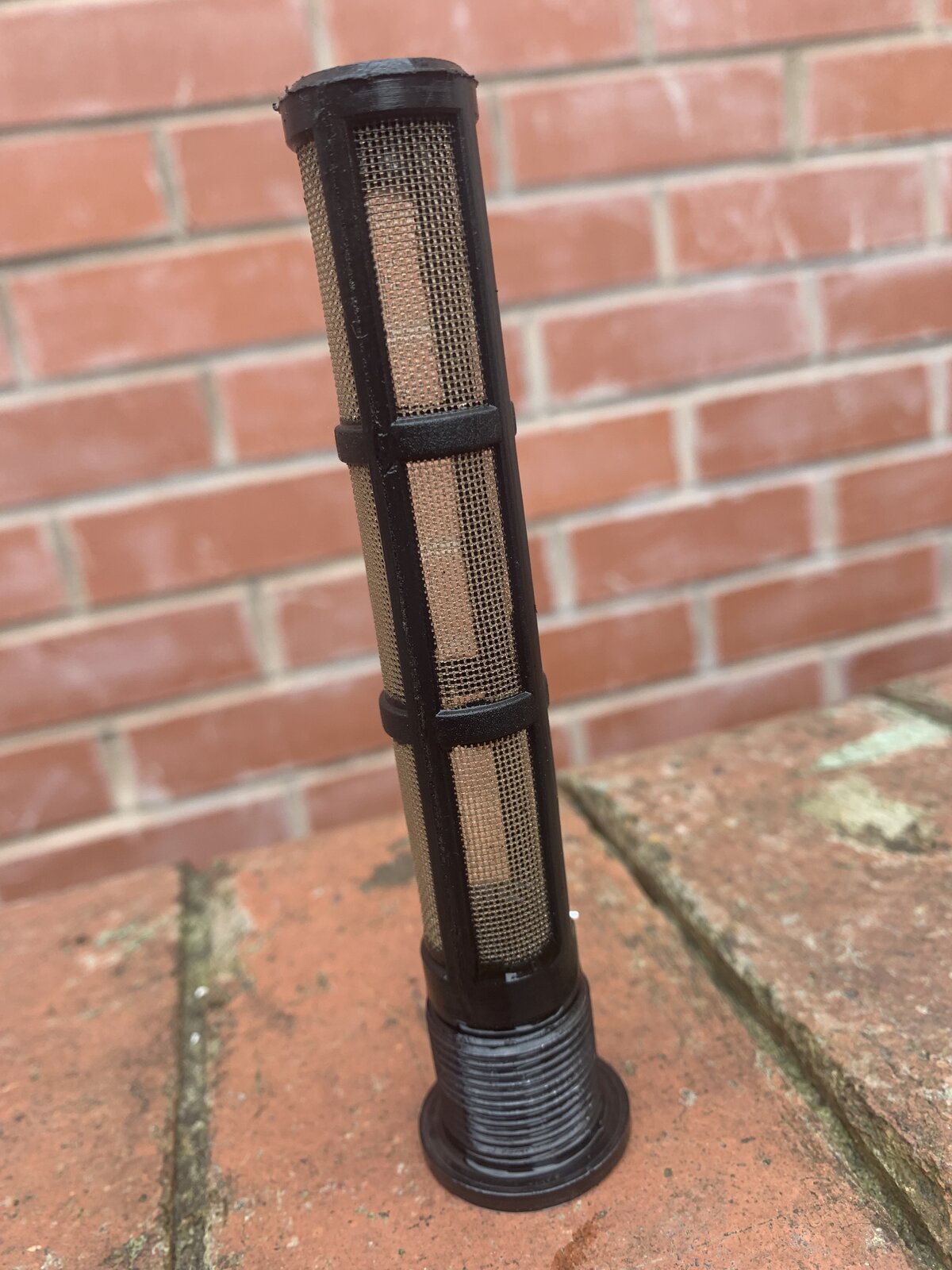

  1. IMG_8234.jpeg IMG_8235.jpeg So oil change done on the 749,wasn’t too bad
    Warm bike
    Sum plug out and let it drain for ages
    Filter gauze out and it looked clean (phew)
    Take off old filter , clean area
    Fill new filter , oil the seal and fit
    New washers on both plugs

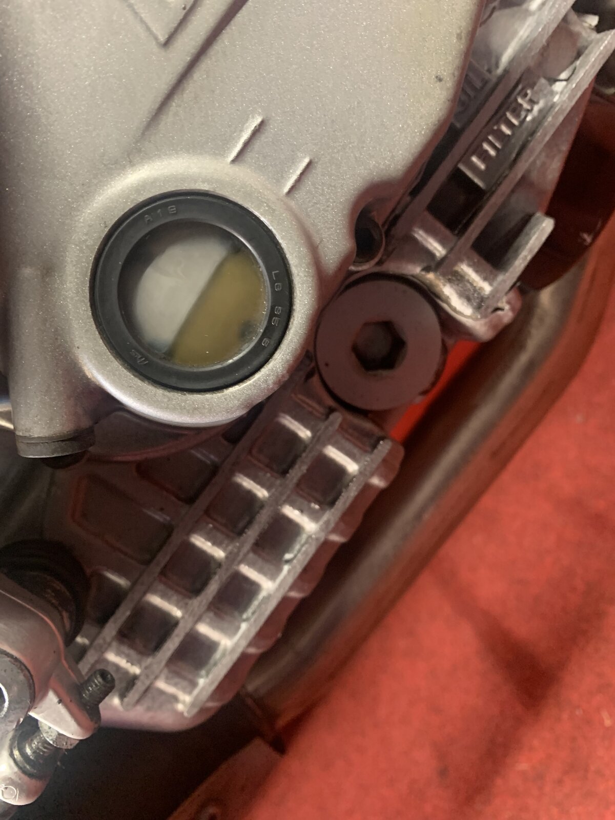

    Fill to top sight glass mark , run for a few mins oil light goes out
    Switch off and let it stand for a while to settle and check sight glass top if needed
    Going to leave till tomorrow the top to just mid way between marks
    All in all not a bad job
