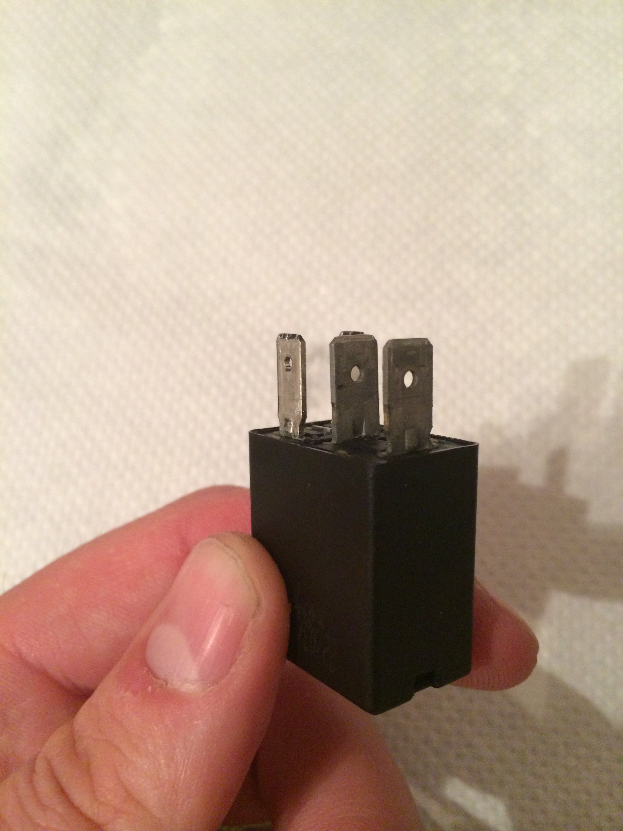

Check the coil/injector/fuel pump relay. You'll find it on the right side of the battery box. There are two there. The front one is for the fans and the rear for the coils etc. They are a cheap part to buy even from Ducati. You need a 12v 4 pin micro relay
Thanks Chris. I'll give that a look ASAP. Would there be any obvious signs of it being duff. Could it be tested in any way to tell or best just to replace it?
Those EOBD errors are classic duff relay signs. You will probably find the relay connectors are covered in Verdi Gris. Even if they look OK, replace them.
Got to the relays. Took them out and they don't seem too bad. I'll replace anyway. Getting them back in is going to be fun! All sorts in the way. Coolent hoses and wiring looms. I'll try post a picture of what it looked like. Don't suppose they have these jobbies down at halfrauds do they?

You appear to have the cleanest relays I've seen in a long time. As Freak has suggested, stick the stock ECU in and see if all is OK. This will be fine, short term. If the problem persists, then change the relays. If still persists then swap the coil sticks and see if the fault changes cylinder. Do the cheap stuff first. If it is the ECU then you know I can help out.
changing the relays should be part of the service regime. changed mine 2 or three weeks back, took it to skye last fortnight its the first time i have done 400mls without some sort of issue since i got it., odd random misfire or flicker of MIL light. never would i of associated them with the symptoms. and there cheep from ducati.

Update. So far; Changed over the ECU with my spare DP one. Error codes went but won't fire up. After two attempts got two of the three error codes 12.2 and 13.2 Horizontal and Vertical injection errors. Changed over the Coil/Injection/Fuel Pump relay with the fan relay. Same thing. Same codes and won't fire up. So I have ruled out the new ECU, and the relay. At the moment I have put it back to how it was with the new ECU and relays back in place. Looks like it beckons the shop and no riding for me in this lovely weather. Any pointers from this point?
