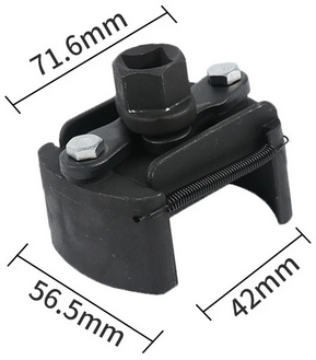

  12. I had no issues removing the OEM Ducati filter on both bikes with this today. I bought this on Aliexpress last year but the link is only for illustration as the original site has changed:
    Nice tool as it's extendable.
    https://www.aliexpress.com/item/1005005275220125.html?spm=a2g0o.productlist.main.7.51635f011GQhUi&algo_pvid=3bfce40e-bda0-4172-b74a-f97931c2bea7&algo_exp_id=3bfce40e-bda0-4172-b74a-f97931c2bea7-3&pdp_npi=3@dis!CAD!25.13!16.59!!!!!@211be3d216828972026442379d07bd!12000032448529596!sea!CA!779041458&curPageLogUid=ArPPzDZOmUhK
    I also reinstalled Ducati OEM filters with it and torqued it to 11 NM.

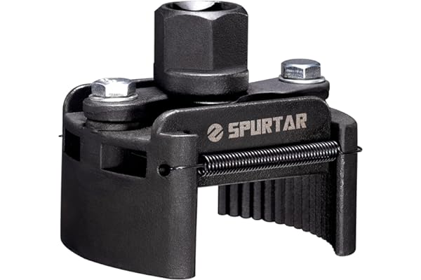

  14. Found this on Amazon, haven't tried but looks ok cost about £12 ish
    Spurtar Adjustable Oil Filter Wrench 60-80mm Universal Oil Filter Removal Tool 1/2'' Drive Oil Filter Tool Perfect Fits Small Medium-Sized Spin-on Oil Filters
    4.5 out of 5 stars 1,179
