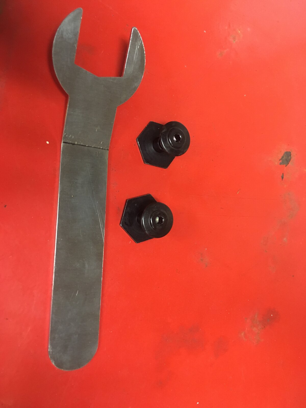

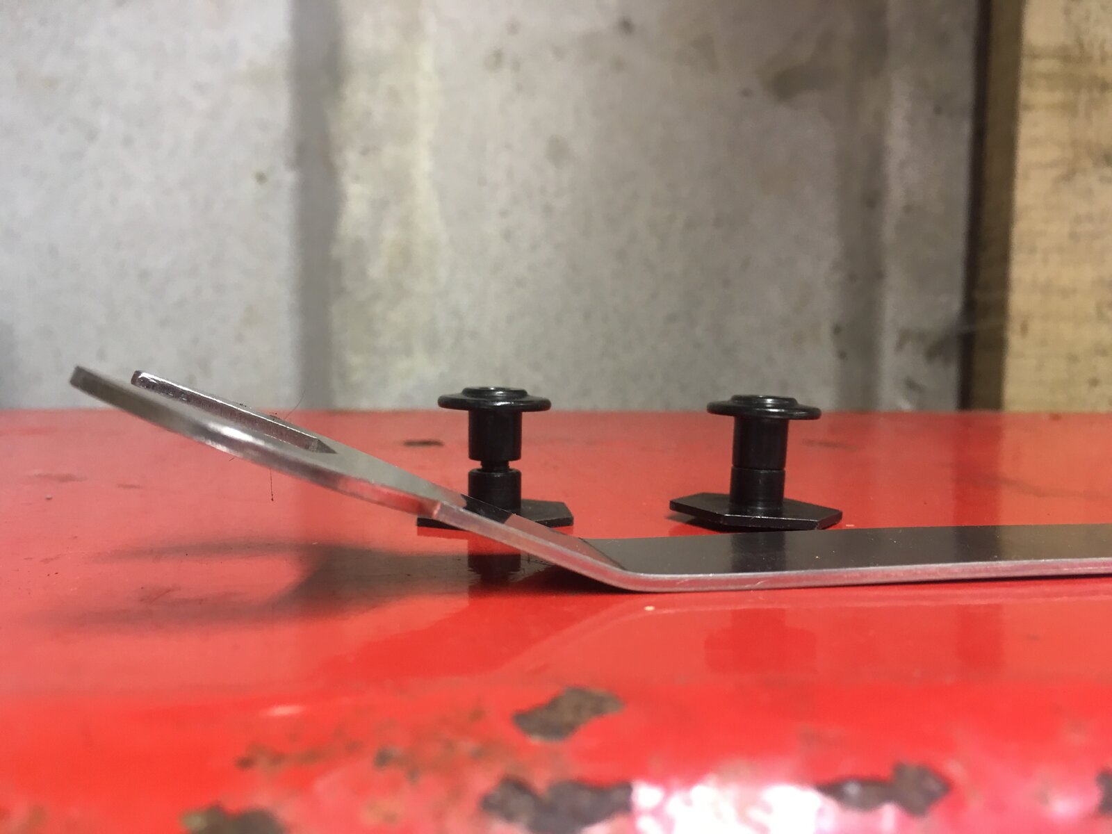

  6. Hi.found the same problem when fitting mine. Got a thin spanner (1mm) laser cut then bent it in the vice.the nut size is 24mm
    Once the guard was fitted I replaced the bottom bolt with I zip tie in case I need to remove the panel at any time.

  7. Great cheers. I'll either try a 24mm socket or make one of these from some sheet metal I've got. Also good tip re zip tying it back on.

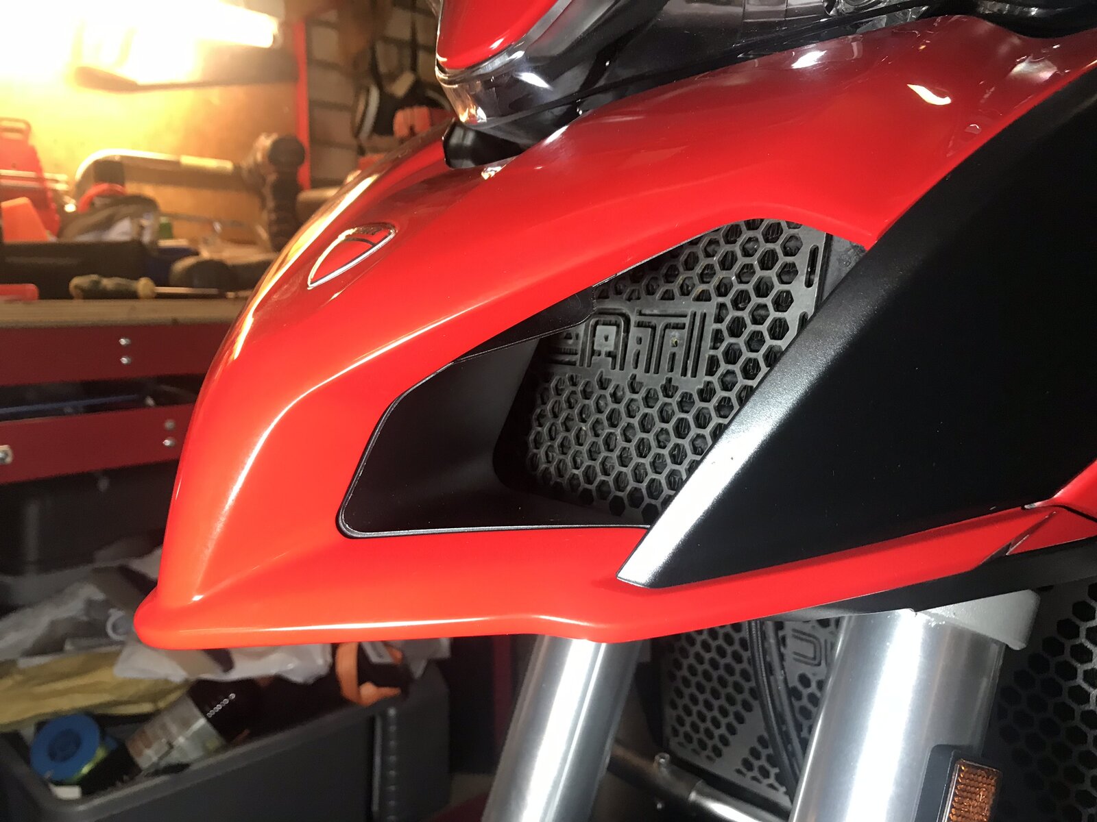

  10. All sorted now, cheers. Ended up twisting the cowl round and removing the bracket from the radiator. Oil and raf guards looking good and took the opportunity to polish and grease stuff too so pleased with that.
