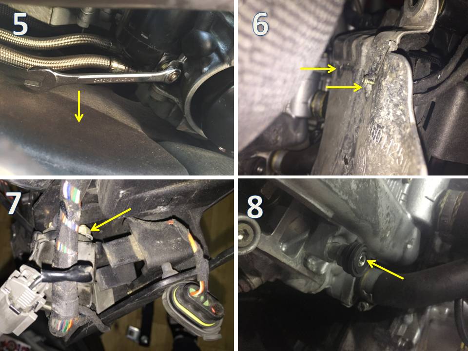

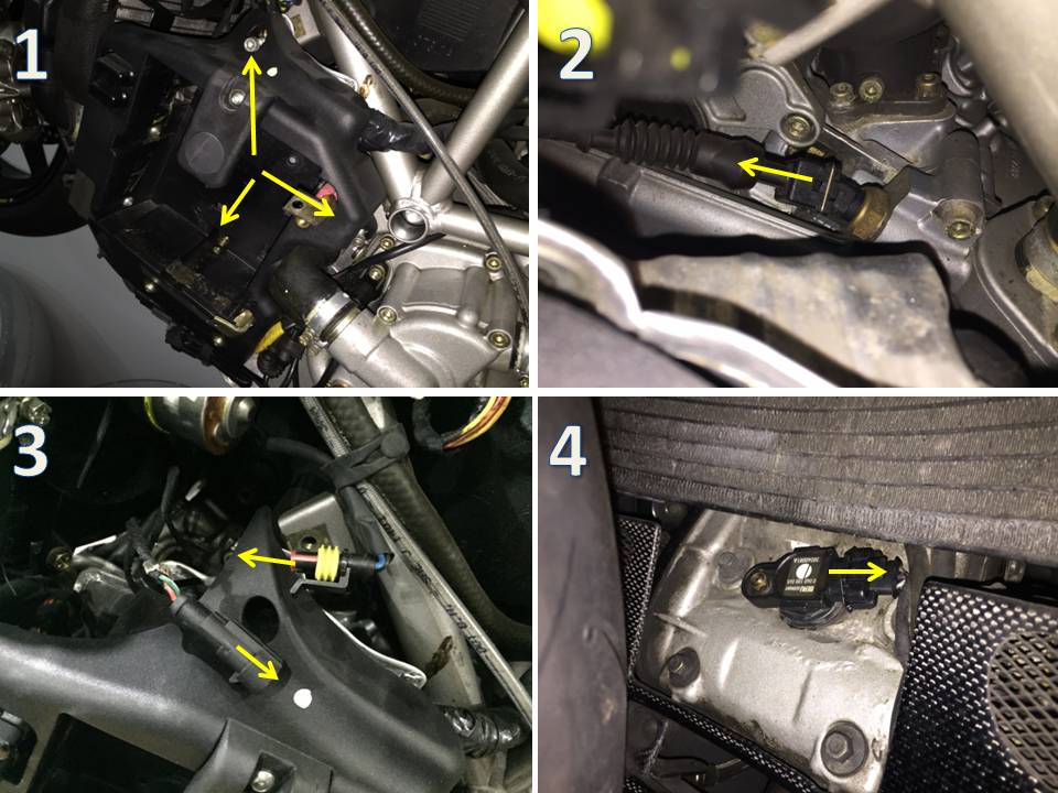

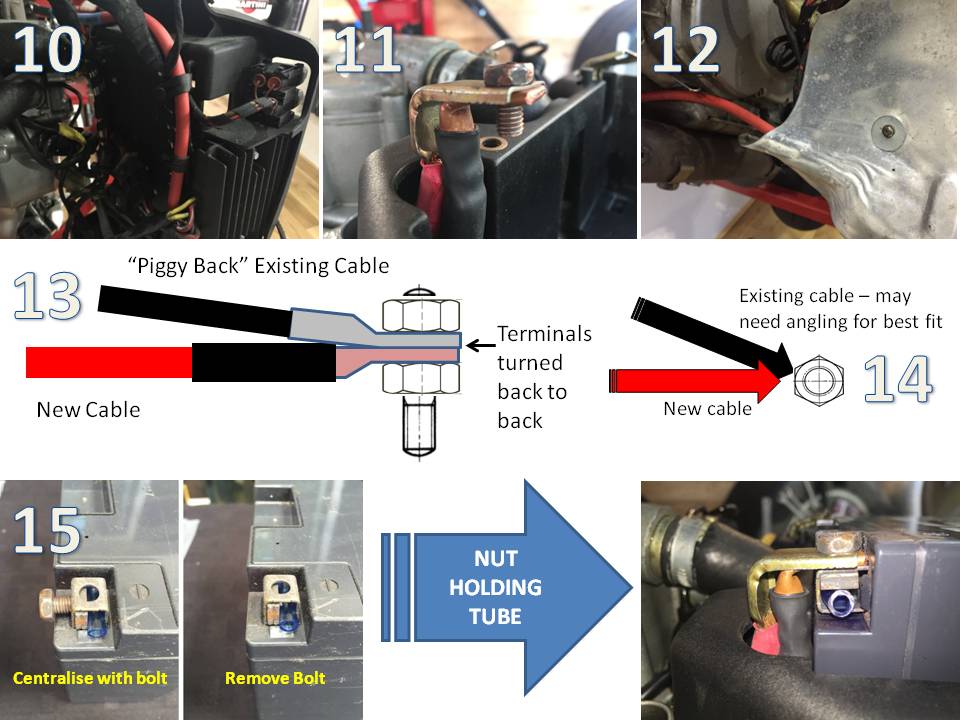

  2. You certainly can do it yourself - it's a bit fiddly just because of the way Ducati have packaged the battery box and loom, but a bit of patience is all it really takes. The kit comes with very comprehensive instructions and photos of each step, so you can either tackle it yourself or hand it all over to any local bike mechanic?
    Cheers,
    Dom
  3. Here's the instructions to read through if you haven't received the kit yet. Most fit in 1 to 2 hours. There was a certain member (TT) that seemed to take a week or two so I don't think you'll beat that record :). It is the trickiest kit to fit but nothing two serious if you have wielded a spanner before. Easier to get a mate to help by supporting the battery box when swung out of the way.
