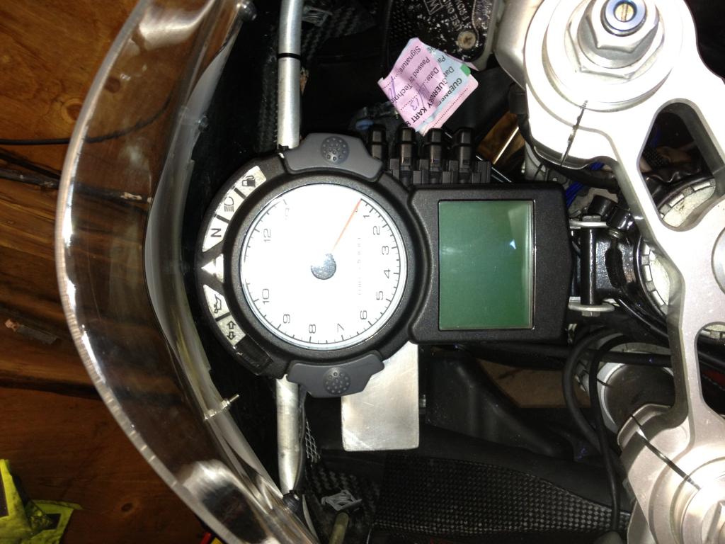

  1. Having purchased the above , I need a couple of pointers please . 1. I have had to make up an ally bracket to fit to my front race subframe, IMG_0734[1].jpg sorry pic is wrong way round I can never remember to hold phone on its side. Anyway that's where its going . I have to connect the different coloured wires to various differing locations, one of them being to the green/yellow wire to the ECU, am I correct in thinking the closest easiest place would be the wiring behind the instrument binnacle (as there is a green/yellow there , from the ECU obviously. So my first question is how do I connect into the terminal block this wire is into, and secondly I have forgotten how to remove this terminal connector from the instrument binnacle ( I did 5yrs ago to pass connector through subframe), but it has behind on the bottom of the push fit pin (the lower one of the three) a metal clip that secures the connector block to it. I don't want to reek this by being a knob with a pair of pliers and giving it a rage fuelled tug.
