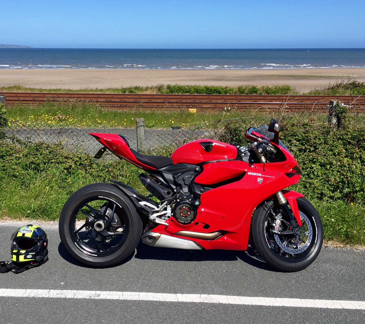

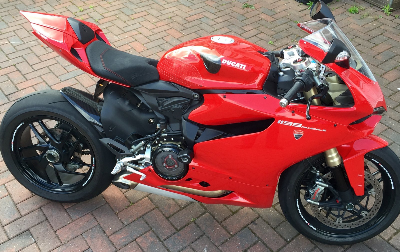

  1. Fitted my dukabike clutch cover and I quite like it .. Some people hate it .. Like marmite I suppose anyways anyone else got one and any problems ?
  2. You're supposed to ask about the problems before you buy it!:D Anyway I think it looks great!:upyeah:
  3. Looks good to me!!! Jon.

  6. What was the import cost of the dukabike clear clutch cover & shipping? please
  7. Yeah im not too sure about them either, at first really didn't like them so haven't fitted one to mine but who knows maybe will change my mind in the future.
  8. Got it from conquest carbon within 2 days cost was roughly £187 with 10% discount and shipping included .. Shipping was quick .. So easy to fit .. Your right ask before you buy .. Done around 100 miles seems good so far .. Looks lovely
    Put on side stand .. Remove the original clutch
    Cover .. Just loosen fairing .. Remove the bolts .. Remove the 3 inner bolts put in the red retainer and torque to 10nm .. Remove old clutch cover seal and push into the dukabike cover and re torque all bolts opposite each other to 10nm as well

  9. Gotta fit my exhaust shield next .. Seems easy with my mini wera ratchet without taking the tank and seat off etc .. Will give it a go next weekend
  10. Put the exhaust shield on aswell new picture .. Will get a paint job next ..
